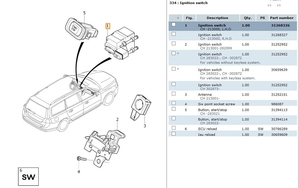

You probably have a bad ignition switch. My shop has had to replace several that had those same symptoms. Unfortunately a new switch requires a software download using VIDA to make it work. On the parts page that's what #6 is - SCU (start control unit) reload
