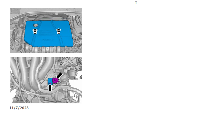

MAPT Sensor location
remove your engine cover, should be right there

The MAP sensor is definitely there where Iroc's pictures. It's attached to the 4th intake manifold with just one screw. It's down there but you can see the wire that comes into it. A bit nasty place but doable. Not impossible. Use very small ratchet wrench.
It has an annoying plug attached.
IMPORTANT: It's better to unscrew the sensor first and only when the sensor has been detached from the engine frame, then safely and easily take off the plastic plug when you have the wire loose. You probably need a small screwdriver to bend the plastic to remove the plug..
The sensor is attached only with a small torx screw.
When it's loose, just pull the sensor out from the hole. That oval part of the sensor is inside a hole and just pull it out with hand.
The MAP sensor was oily and filthy as sh*t.

Here's the MAP sensor photos.
You just push this oval shaped part into the place. It should snap there and then attach the torx screw and then finally attach the plastic plug and wire.
