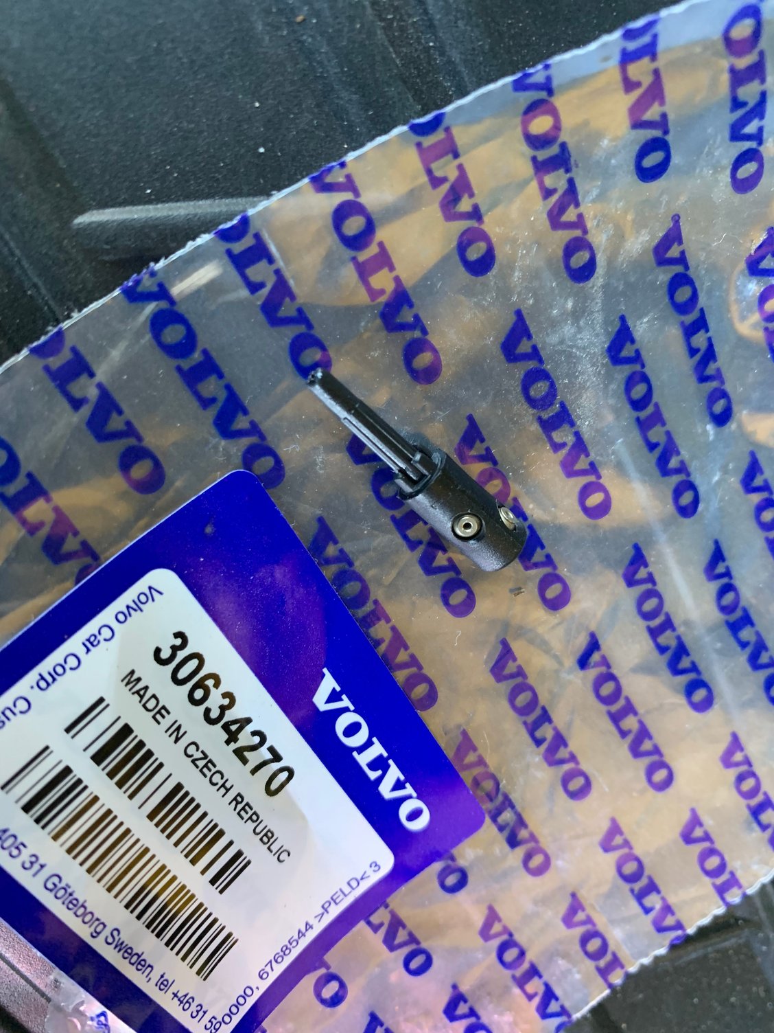

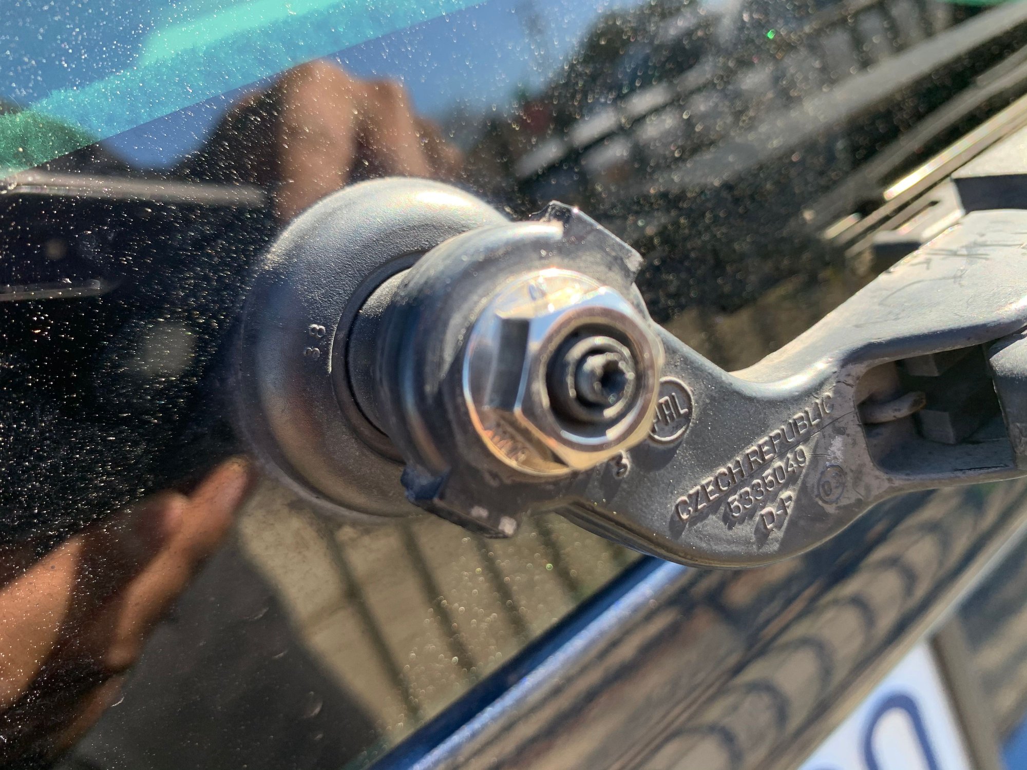

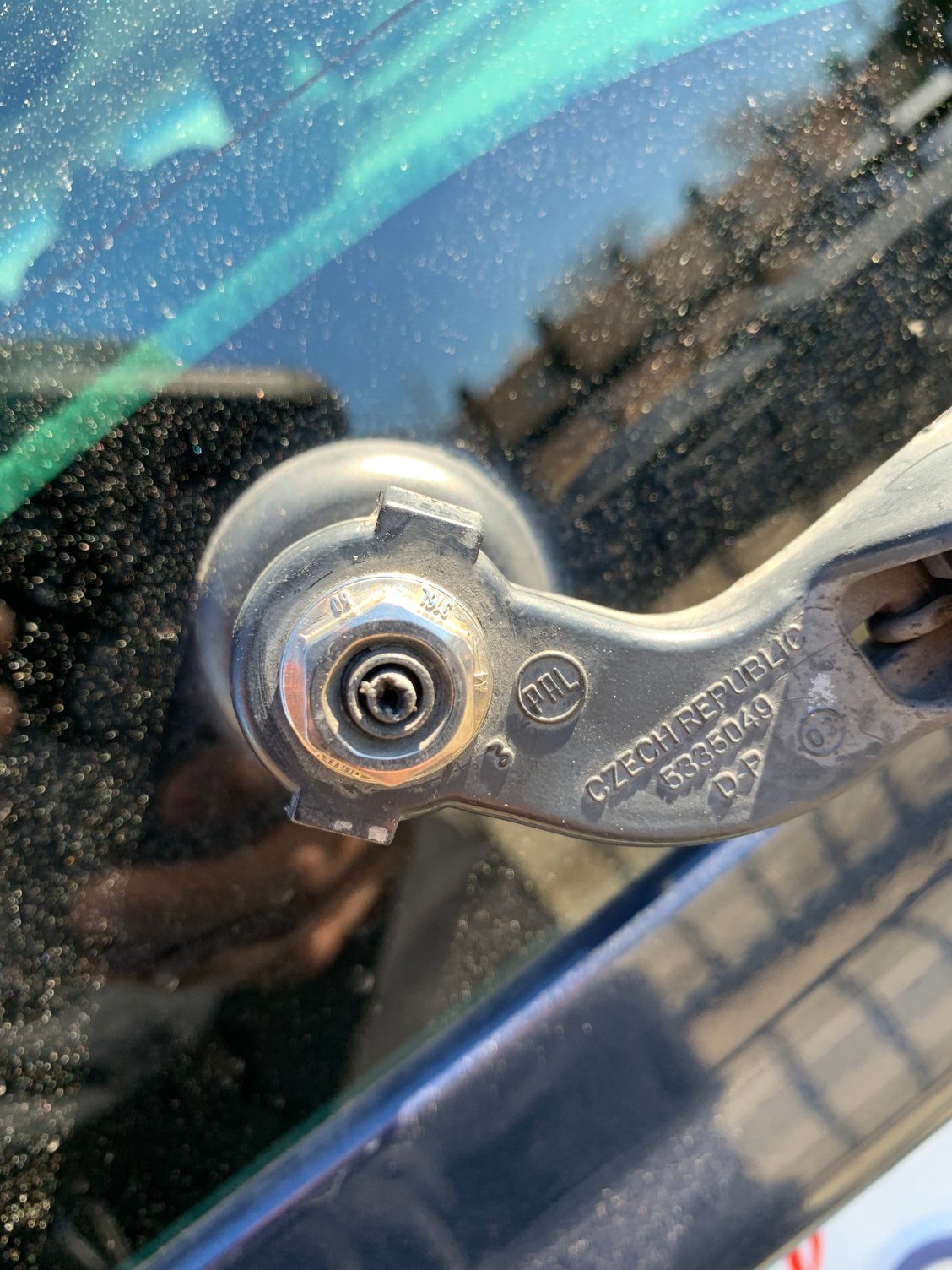

Hello, I have recently purchased a 2004 Volvo XC70 and I noticed that the rear washer nozzle was missing/broken off. I purchased the nozzle thinking it would just slide into the hole, but I’ve ran into some issues doing. The outer portion of the washer seems to have either broken off or it’s been corroded of some sort. I’m really looking for some help on how I can I fix this issue since it would be nice to have a clean rear window every morning. I’ve attached images of the rear washer and the nozzle piece that I purchased specifically for this model vehicle.

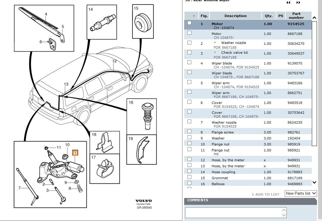

if that does not fit - you might need to buy #3 or (#7) depending on your chassis # . And #6 covers it up.
Thank you so much! This will help out tremendously! It looks like #7 is the one for my vehicle, I already have #6! Would I have to disassemble from the interior or the exterior of the trunk?
Old Feb 1, 2021 | 07:33 PM
Yes''' from the inside
