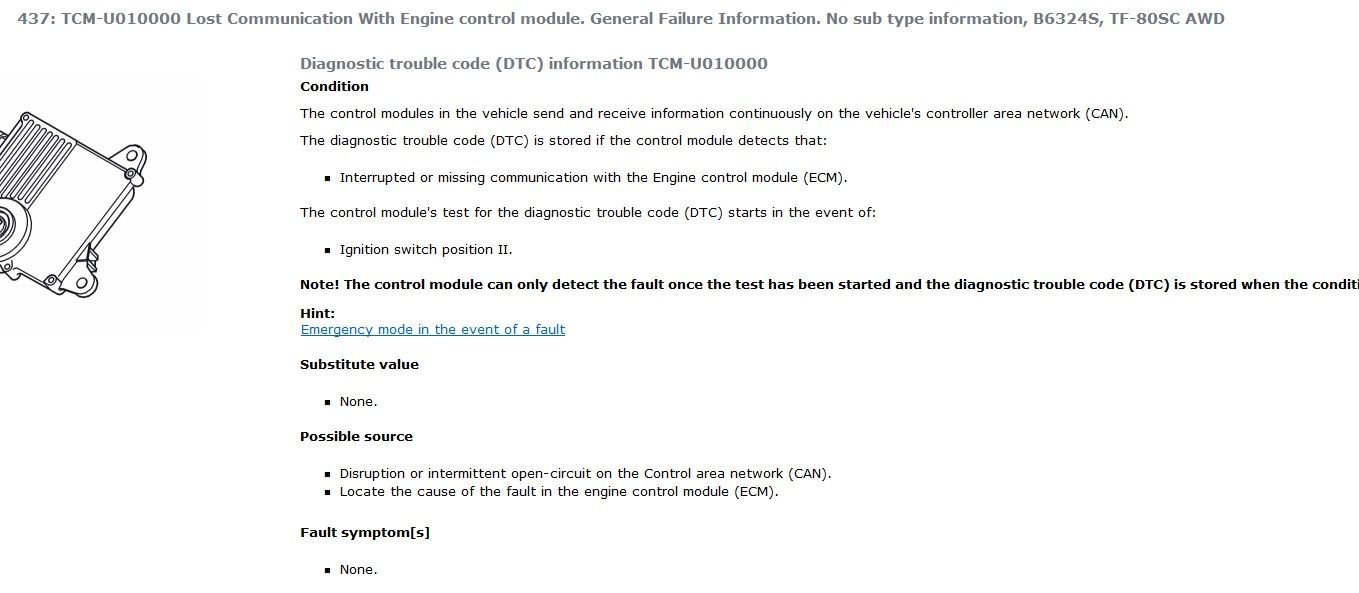

I have purchased a new ground negative cable and installed it. the battery has been tested by me and at auto zone (interstate bat w/ 12.48ish v and good CCA) and its 4 months old. I even took out the battery from my Infiniti which is also a year old and no start. Ive also gone and checked the fuses and they all appear to be good. I don't have vida/dice but did have a Volvo specific icarsoft which is showing me no communication with multiple modules and 2 obd codes (p1719 & p0725). could this be the dreaded BCM issue where I have to get it replaced? on the P3 is the BCM also located similar to the P2?
these are some codes the icarsoft shows for certain modules
TCM (p072500 P171900 U010000)
DIM(U14000 U042268)
CEM(U010000 U012800)
ABS(C004087 U012800 U010000)
PAM(U042200)
DDM(B118E00 D119000)

Your scanner puts out Volvo codes. Most of those codes (all the uo10000 codes and some others in each module) are communication codes with the CEM. Have you had a bunch of rain and the car is parked outside? You may have gotten water in your CEM. Or the CAN network was damaged somehow (probably not from water) . Common failures courtesy of xemodex.

after sending it to a local Volvo specialist (Dallas Elect auto center), he said the ecm wasn't active in the module network. it wasn't visible. he recommended I take it to the dealership but after talking to XeMODeX I decided to save a bit of money and send it to them. they got it and told me their system could read but it could still be bad. I decided to have them transfer the data from my ecm to a refurbished one they had(~$700). got it super fast back and installed it. during the time I sent out the ecm I acquired a vida/dice system. so when I got the ecm back and installed it I ran vida and saw that the ecm was active and almost all my codes disappeared.everything looked good in vida. but also in the time it was shipped out my wife accidentally washed the fob. so the car still wouldn't start. but everything in the network was active and working and no codes. finally decided to send it to the local dealership, I thought the fob was bad but they said it wasn't and ran a 3 hr diagnosis ($600) and only replaced the main relay($25) in the fuse compartment in the engine bay. it started!! picked it up and drove it home.
