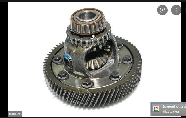

Car in park, parking brake on (to keep car from rolling). Jack one front tire off the ground. Try to spin that tire with your hands. If the splines from both front axles are engaged in the differential spider gears and the spider gears are not broken - you will not be able to spin the tire that's off the ground. If you can - axle spines are not engaged or the differential is broken (have not seen a volvo do that, other cars yes) If the car still does not move and it grinds putting back in park with the engine running - the differential ring and pinion is broken (there again have not seen that in a Volvo FWD transmission)

I did what you recommended and each front wheel spins easily in park while jacked up one at a time. Is this a surefire sign that I have a broken diff or ring and pinion? At that point would it be better to get a Reman or takeout tranny and swap that in? Thanks for your help, I really do appreciate it.

Does the driveshaft spin when in park, one front wheel on the ground, one up and spin by hand? If so the differential is spinning - the transfer case is connected directly to the ring gear housing.
If teeth break off the spider gears or the ring and pinion - there's not much room for those extra parts to float around - and things get real ugly when those loose teeth touch spining gears. I'm just having a hard time believing teeth are broken, not having seen than in a FWD volvo transmission. Certainly have seen that in Volvo RWD diffs, and manual transmissions.
