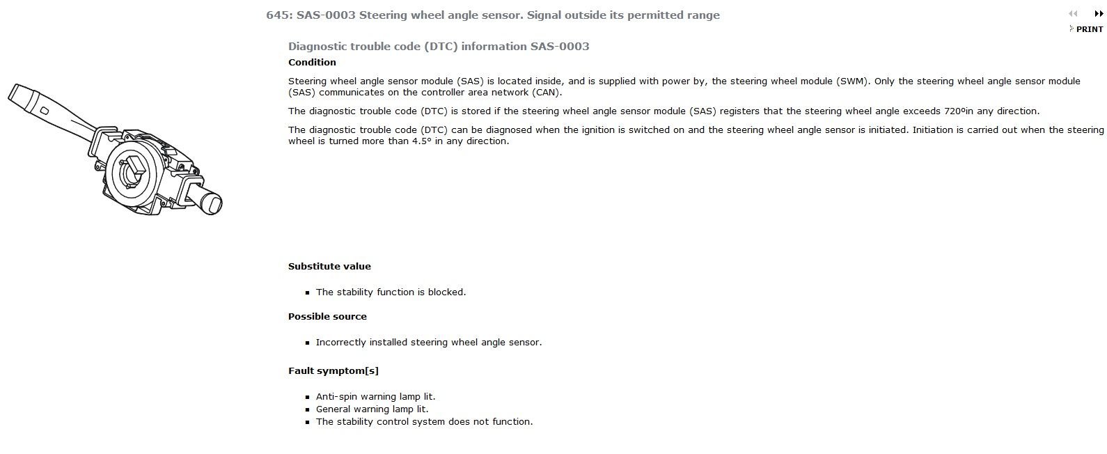

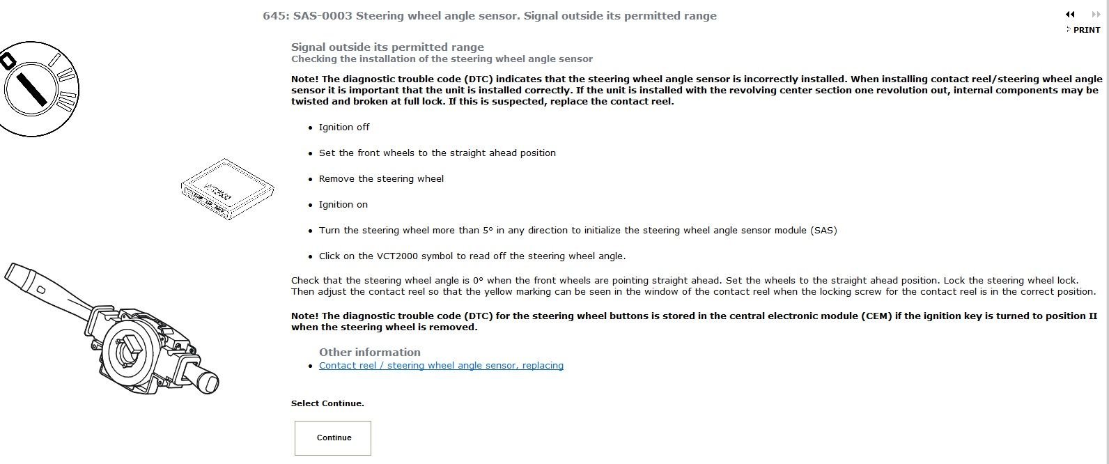

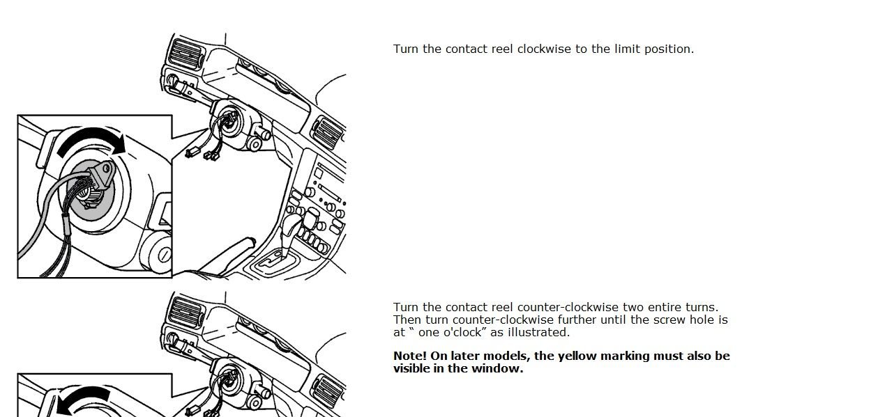

No "programming" needed, they come locked into hopefully the correct position with a little screw - Volvo does suggest making sure the clock spring is set correctly - it only turns so far in each direction. Their directions below.

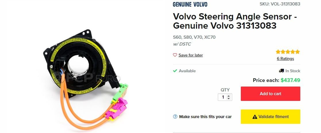

I replaced my clock spring with 31313083 from a functioning 07 xc70 and put it in mine. I now get dstc spin control off and anti skid temporarily off. Does this just mean that it now needs to be calibrated? I called volvo and they said that you can not put a used one in because it will not work. Must be brand new and then has to have software installed and then calibrated. Is this true?
