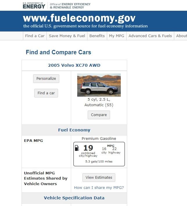

"What is common for this vehicle?" See below courtesy the US dept of energy. Looks like 16 in the city is normal using premium. For Subarus that info is here
https://www.fueleconomy.gov/feg/bymake/Subaru2005.shtml
