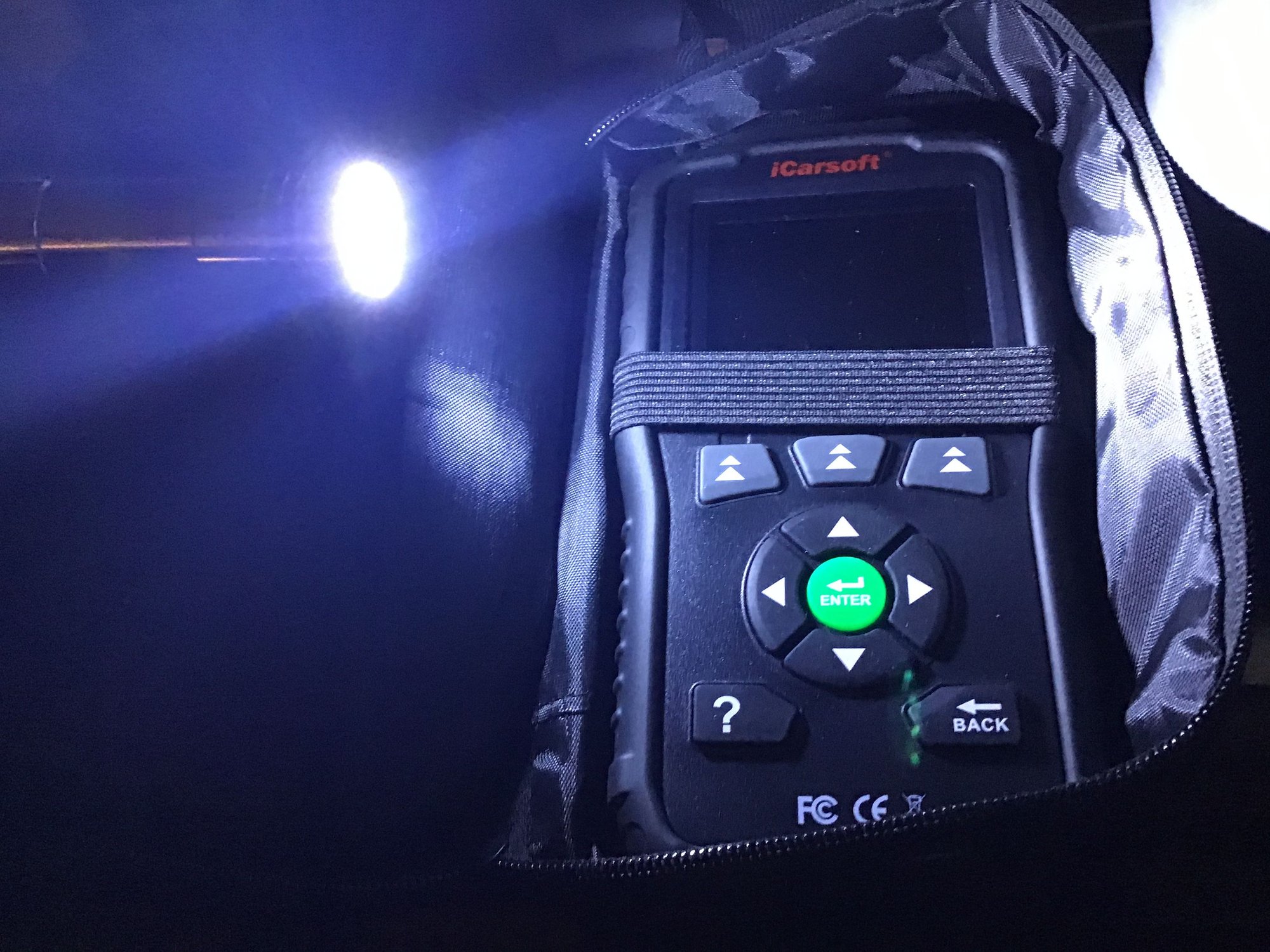

ICarsoft scanner.
Old Sep 12, 2020 | 05:29 PM
The DEM is not considered a emission related module - Can you access DEM codes?
Old Sep 12, 2020 | 05:33 PM
Geophagus's Avatar
Joined: Sep 2020
From: North Eastern United States.
It does more then that. I can look at the entire electrical system with it. The different modules and such. If the right rear turn signal is out I can see it on that scanner.
