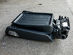

Hi,
I'm in the process of trying to replace the armrest in an XC70 (2006)..I've seen some instructions online BUT I'm not sure how to remove the silver end caps that are over the ends of the hinge (see photo)....I'm hoping I can just remove that piece and swap in the new one I have (see other photo) without removing a whole lot of the central "tunnel" console...
Appreciate any help,
Thanks,
Alan,
Attached Thumbnails Replacing Center Console Armrest-20180915_volvo_014.jpg   Replacing Center Console Armrest-20180915_volvo_016.jpg

Did anyone ever figure this out? In process right now but having issue getting entire console over emergency brake....do not want to break any tabs or plastic if possible, goin at it blind.

I assume you got this resolved since it's been awhile. Haynes has pretty good instructions for this if anyone else is dealing with it. I replaced the console in my 2004 V70, you have wiggle and jiggle it but it's doable.

In case anyone else is struggling with this, have replaced or modified the center console in my 2004 V70 and 2001 XC70, it isn't hard but there are a few tricky parts. 1A Auto has an excellent video on this.
