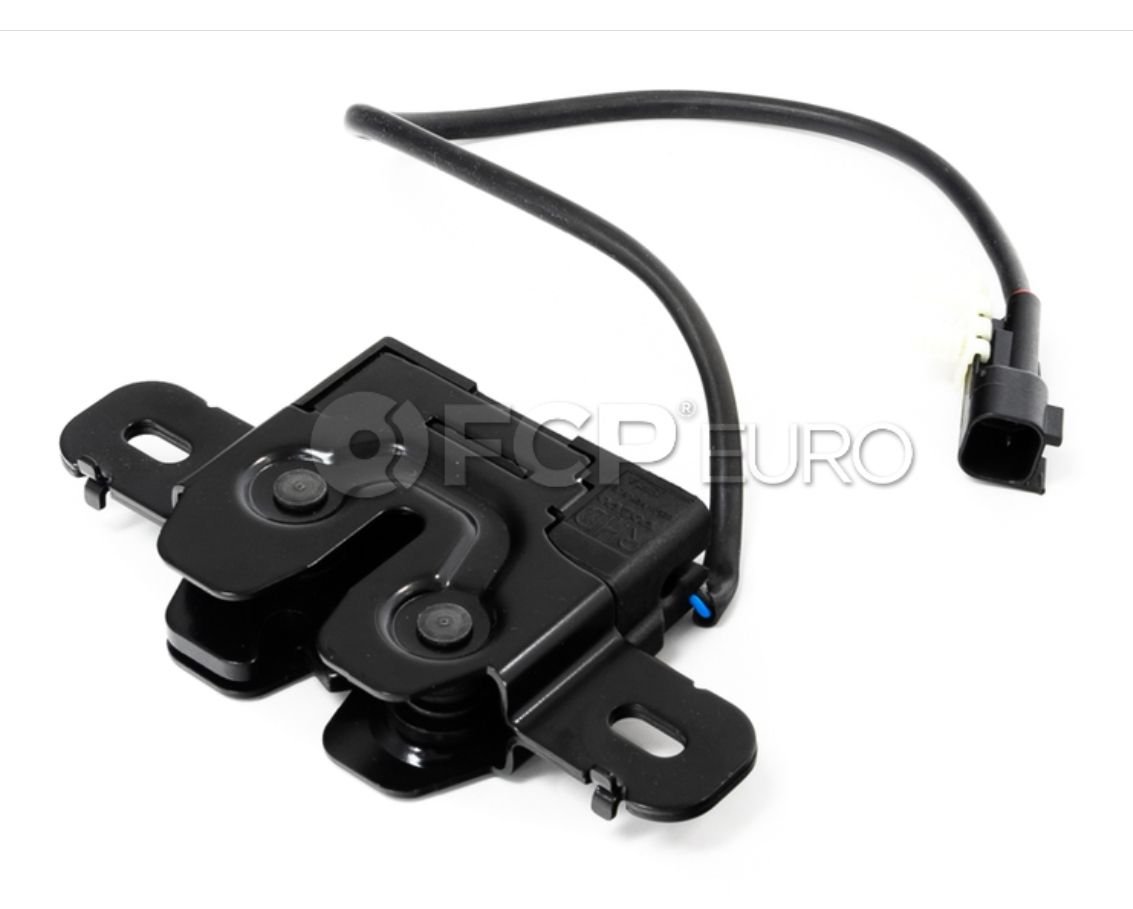

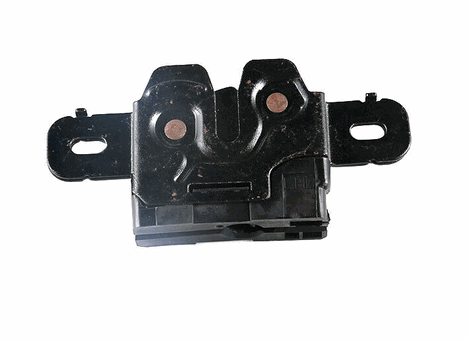

You have to disconnect the cable from the lock and remove the lock. Once the lock is off of the car, then you can brake clean spray it and try to work the mechanism to see if it will free up. Clean it off, Spray WD40, and then work it. If you can get it to consistently lock and unlock, then you can reuse it.
The cable is merely pushed onto the bottom. You have to separate the bottom of the lock from the top--using a flat blade screw driver.
I had the benefit of buying a new lock and with the new lock in hand, I was able to see how the cable actually attached, and how it actually worked. You can buy a new driver's lock, and if you do not use it, then return it for 100% refund. If you cannot get the old lock to work, you will need the new lock anyway.
Once you have the new lock in your hand, you will understand how it all works.
I attach picture of one driver's side lock and one passenger side lock--with wire for alarm.
If you look at lock from topside up--where the (two) screw holes are, attaching the lock to the body of the car, there is a slot 3/4 of the way down the middle. Pry in that slot with a flat head screwdriver, and the bottom of the lock will detach. That's where the cable is attached. You can push in there to engage the release simulating the cable pull engaging the release.
The best thing to do is to get a returnable new Volvo lock. Once you have it in hand, you will understand better than any words or picture can explain.
