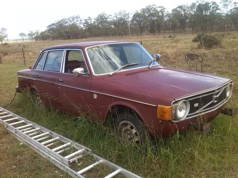

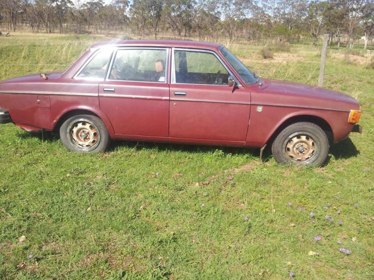

This is my new project, a 1974 144 GL automatic.

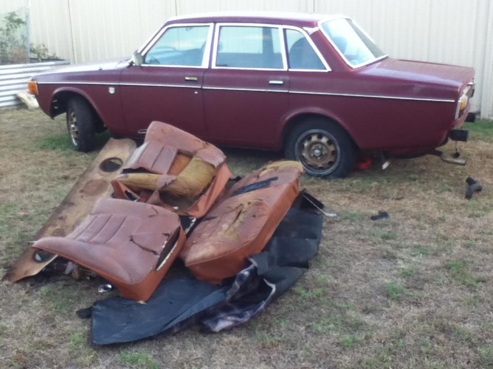

I acquired this car on the 2nd of March 2014, which I got free just for towing it away. The plan is to strip it out, clean it up and race it on a very low budget.
Haven't had much time yet, but with help from my mate (who will be helping me along the way), we managed to strip all the seats and carpet out, rear bumper off (front already removed) and tow bar kit off.

This is where it stands now, I also gave it a wash this afternoon.

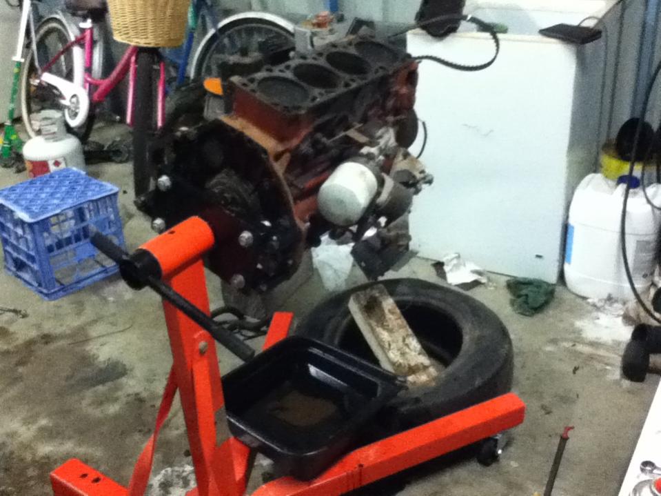

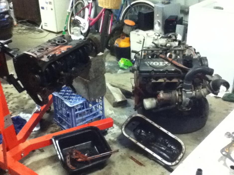

Okay, the carby plan is scrapped, too much work with the turbo. Picked up the engine today, I forgot to mention I got a second spare engine as well as the turbo one. I also got a rear axle including the diff and 2-pot brakes. My backyard now looks like a scrap yard, motors are at my friends place because there was no where to work on them at mine, and he's stripping them down and putting all the good parts on the turbo engine.

NA engine stripped completely, turbo engine stripped down to the long block ready to be stripped completely tomorrow to compare the parts.

Bearings on the verge of catastrophic failure. Yes, that's shaved metal barely hanging on and burn marks, also scored badly. They're out of the spare engine, but the spare does have higher comp pistons and has been ported, and the bore is in excellent condition.

After assessing more options, decided to go the budget route for the first engine. Using the (better) turbo block, removing the turbo and putting on a cheap carb kit, only replacing the conrod bearings, main are fine. Not sure which head we'll use yet, but we'll use the lower comp pistons, don't want to risk blowing the engine on the first day of racing.
The bore looks pretty good, would say less definitely less than 100k miles, maybe less than 90k. But we'll keep the same rings, they should last long enough until we have the second engine completely overhauled, ready to swap in when this one goes bang.
Turbo motor stipped down now too.
