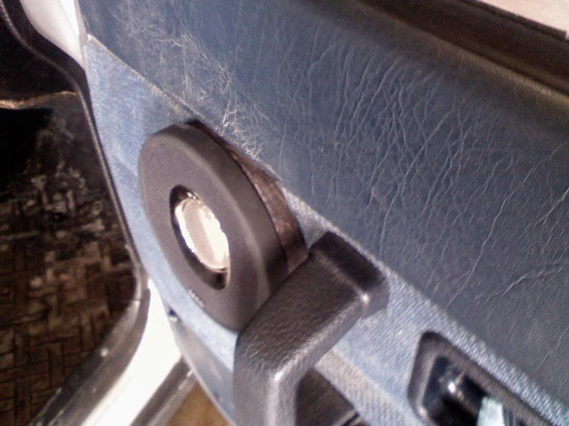

I had to do the same thing. Problem with Volvo speaker requirements is that you can't just buy any 4" speaker....the mounting depths on most of them are too deep. Infinity sells them with 1 13/16" depth with is just enough to squeak 'em in the doors. Althought, if you're handy with wood working you can do what Kaspir and I did....it'll look something like this (Maybe a little better....I rushed mine):
