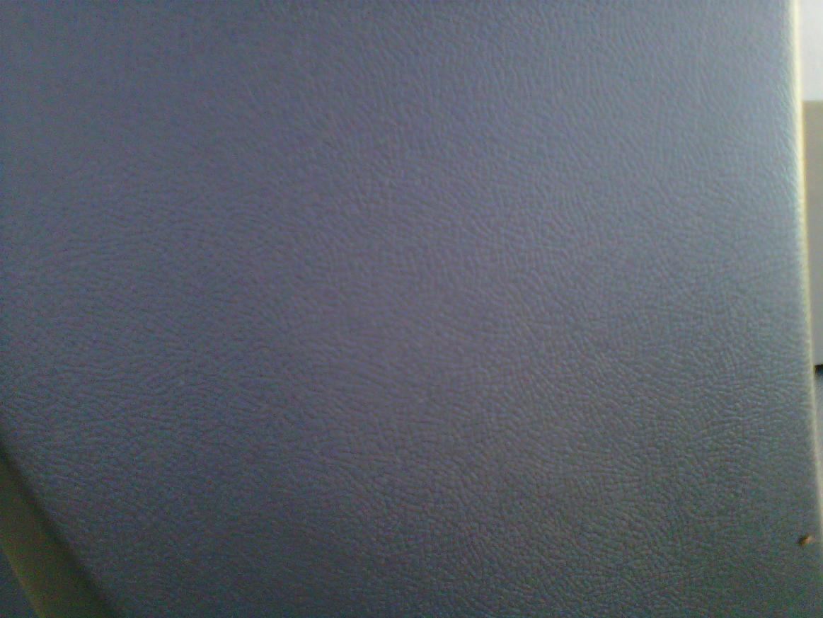

My 2001 xc70 has the blue-gray bumpers and trim that have faded and are scratched. I just bought 2 bottles of " Showroom New " and dyed all of the exterior plastics. I opened all the doors and continued with the dye application into the cabin area & got on the creeper and did the trim under the car. A little much I know, but I'm a painter by trade and didn't want to waste any of the dye.
Prep work: Since I had several scratches and deep gouges I decided to sand these areas with 400 grit paper then I washed all areas and let it dry.
Dye application: With the car parked in the shade, I applied the Showroom New with a disposable foam paint brush. (Directions recommend taping off the trim area, but I did not. I have a steady hand until coffee time).
Results: I let the 1st coat dry for about 1 hour and was really impressed with the results. It looked so good I didn't need a second coat but just a few touch-ups on areas I had missed or allowed to streak. Since I don't have another car w/ gray trim, I did a second coat on the front bumper and I did touch-up on my console (ac and radio buttons).
Cost: 2) Showroom New 4oz. bottles $36.00, 2) foam brushes $1.59, 1) mini roller paint tray $1.99. LESS THAN $40.00 TOTAL and the car looks so good!
Time spent:
10 mins sanding, 30 mins washing, 2 hours total dye time.
FYI: I do not sell this products and will not rcve any compensation for this review.
Attached Thumbnails Showroom New plastic trim bumper dye review-volvobumper.jpg   Showroom New plastic trim bumper dye review-volvob4.jpg   Showroom New plastic trim bumper dye review-volvoafter.jpg

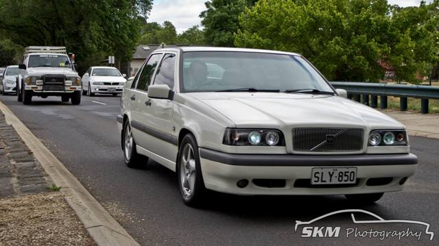

I have used showroom new on my 850 now, it is one of the best products for the grey bumpers that I have ever come across. I usually have to re-coat it every couple of years, we get some pretty hot sun here in Australia.
Attached Thumbnails Showroom New plastic trim bumper dye review-cruisesmall1.jpg
