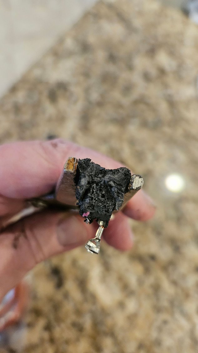

Connector is 30644648
wiring terminals 31252715.

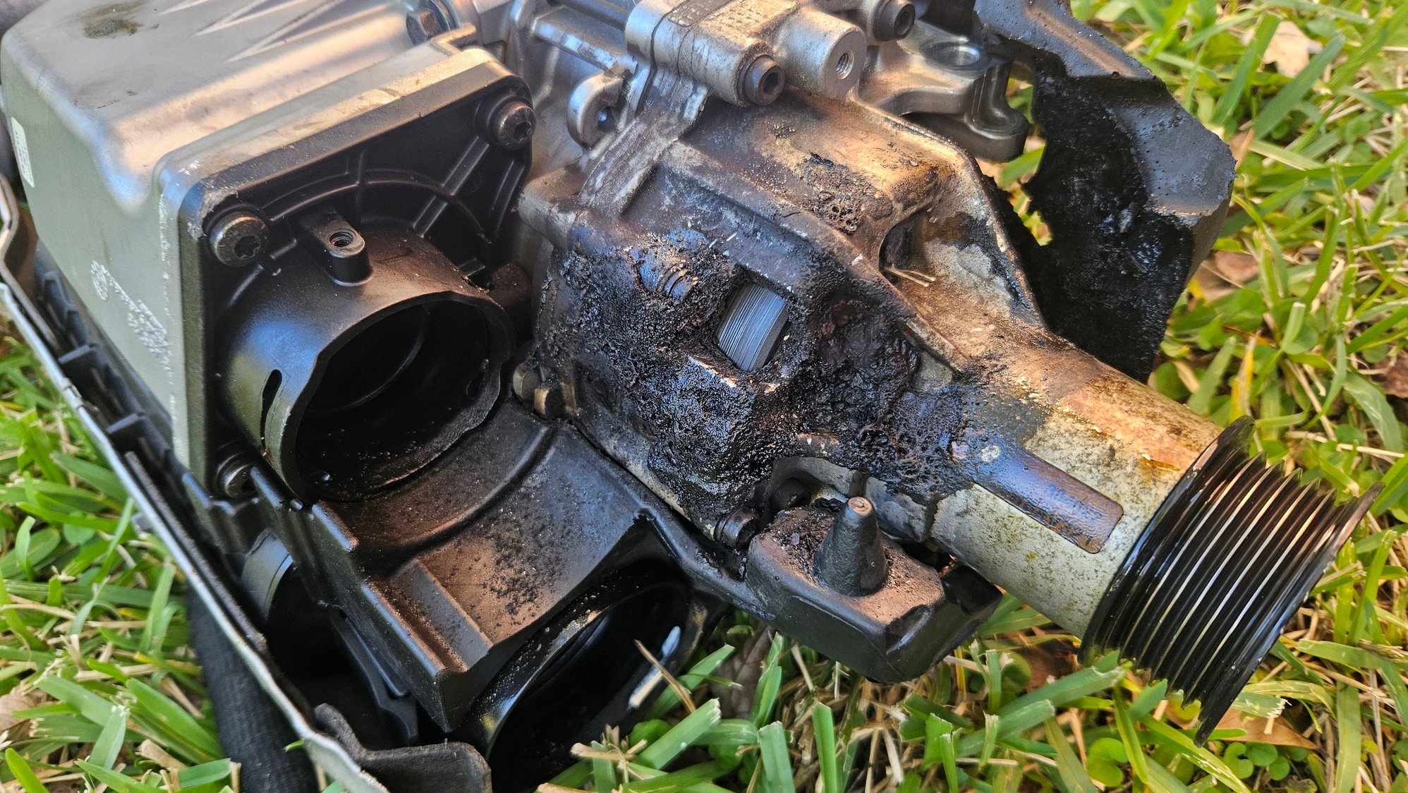

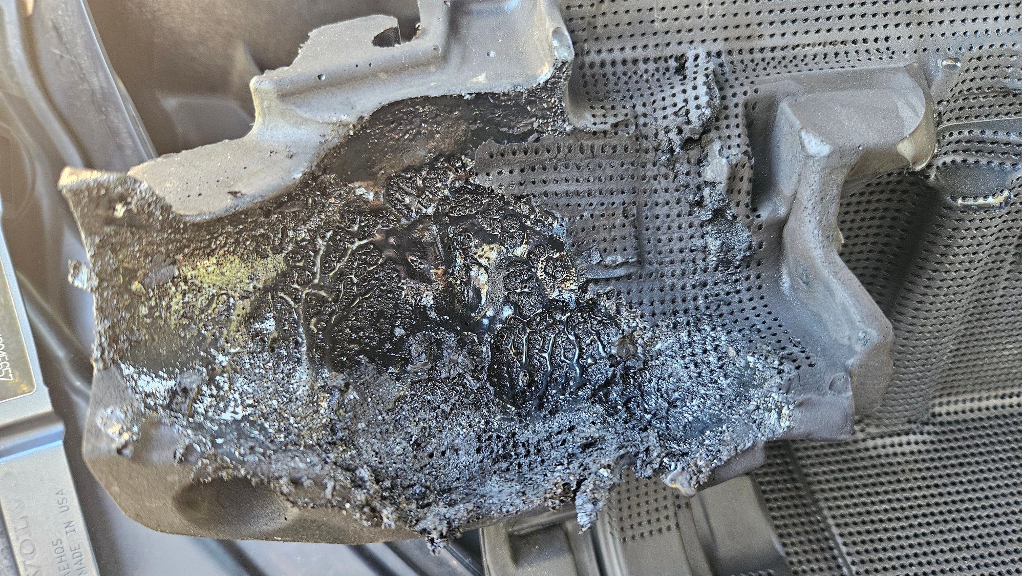

I know because my Supercharger failed at 68k and nearly caught my car on fire. The clutch literally melted everything including the connector....
FCP Euro has the kit to replace the supercharger. It's about $1600.
