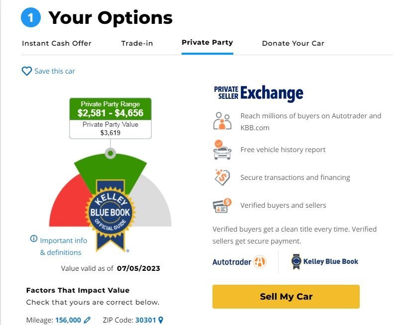

With those codes you could easily need a steering angle sensor, a brake pressure sensor, and the communication problems could end up being anything. (CEM?) Are you getting a really, really good deal on this car? And are willing to possibly spend a few thousand dollars making this into a safer car for your son?
According to KBB.com that's a ~$3600 car. Then deduct what the reasonable repairs might be. Is that is the ball park for what your neighbor wants? Sorry, just trying to inject some realistic/rational thoughts into the conversation. Be sure to add in the $180-200 cost of a new correct battery (that won't give you low battery messages) into your deliberations. And I saw your thread on Sweedespeed - it's good to check all resources you can find.
