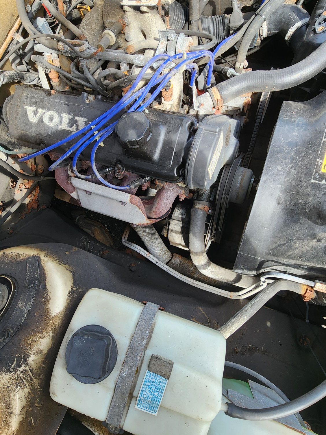

Hello everyone,
I was working on my car today and noticed something very unfortunate, a clean cut in a pipe I have no idea what it is.
I don't know how long it's been broken apart for as I have notice no performance issues.
What is this part and what is its purpose?
Thank you for your help and consideration.
Old Sep 24, 2023 | 04:41 PM
Intake air preheater tube. In most climates it's best to remove it. (If legal in your jurisdiction)
The other end is on the bottom of the air filter box - and I'd bet if you look inside the air box behind the filter - you will find a bad air box thermostat routing preheated air from that tube intake the intake all the time. (instead of just when it is below ~35 degrees)
If stuck in the hot air position - it tends to fry your air mass meter. $$$
