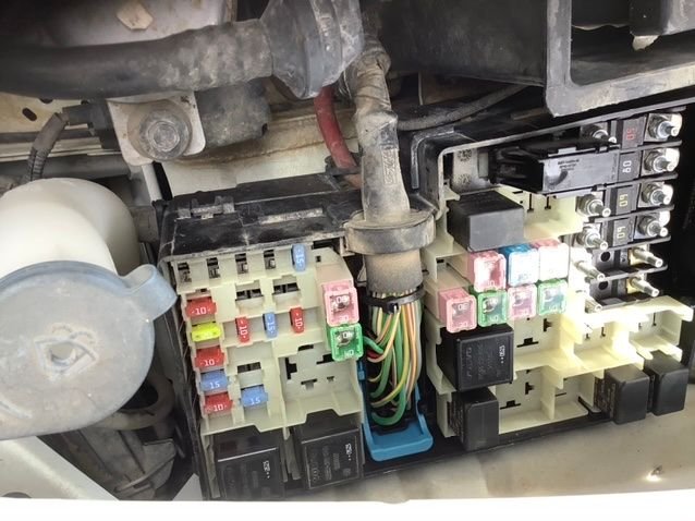

My 2006 Volvo v50 giving me fits again. Starter engages only part way and happens as it gets cold. Unpredictable and sporadic. New battery. I think it is the alarm system battery that is draining primary. Primary only showing 12.1 volts after parked awhile in cold.
a mechanic lost my owners manual....I would like to remove fuse for alarm circuit. Anyone know which fuse?
see pic
Andy

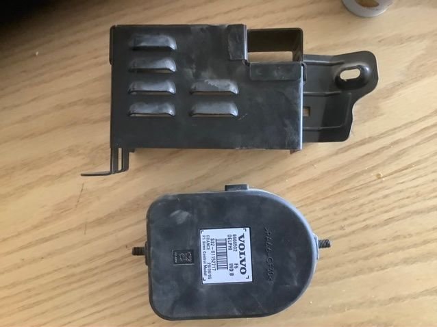

Found the siren module and removed it. Still seemed to be a current draw until I removed fuse 51 “Additional heater for the passenger compartment, AWD, fuel filter relay, heating”. So I removed siren, see picas well as fuse 51 and 56. Will see what happens....

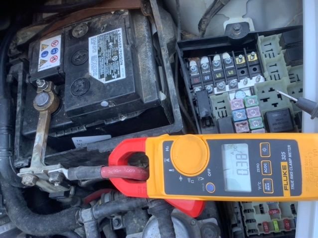

Well, it seems better on starting but the real test will be when the weather gets cold again. When I turn off the engine and check current drain it is still quite Hugh, like 1-2 amps but then quickly goes to 0.40 amp. I guess the on board computer, clock etc arealways drawing something. Just not sure this is reasonable. See pic.

Modern cars electrical systems can stay awake pulling current for awhile. Depending on the car some systems can be 5-10 minutes before going to sleep/shut down. Open hood latches can cause draw.
Using an amp clamp on the battery with the hood open you should latch the hood latch/latches. Key out of the car. let the car sit undisturbed for 5-10 minutes and then check the draw.
Also in your picture you have your amp clamp on one wire but there are other wires coming off of the battery there. Ideal location in this case for the clamp would be on the part coming off of the battery post so you get a reading of everything coming out of the battery.
