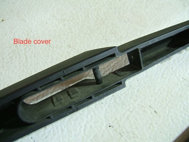

Simple thing to do but I've never seen it explained. The manual is vague but essentially correct, you just pry the wiper away from the arm. Once you see the photo below it all makes sense.
Blade just pushes into the clip on the arm

Should clarify the previous post. The bosch part number for the rear wiper blade assembly is H370. This assembly includes the blade itself and a cover piece which I labeled as "wiper arm" in the previous photo. The blade and cover piece comes assembled, and you attach that assembled piece to the "Arm" that is attached to the wiper motor. As you can see everything pulls apart with some leverage, there are no complicated clips or screws. See the additional pics.
