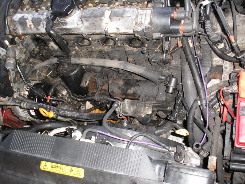

When I bought my car I knew that it was going to need a new oil breather box under the intake because of all the internal smoke that lead me to beleieve the sytem was clogged somewhere, so I ordered a replacement kit for the box and all the hoses off a certain website, and I read up about the procedure on the web, so I was hoping I could figure it all out once I got into it. I went relatively smoothly getting it all done from the top side, the bolts underneath the intake were kind of a pain, but it came apart rather cleanly. I cleaned out the ports in the block, and I have all new hoses to put it back together (new O-rings and clamps as well) so hopefully tomorrow this will be done. Not the worst episode ever, but not the easiest either.This car is rather easy to work on though, I must give it full credit there.
