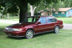

Here is a description of the ad for the car and the two pics....from all I can tell, the seats have a tear? Not sure....What are you guys thoughts on this car? Asking price is $1,200

Looks like it's been rode a little hard. I would suspect that it has some body damage. The price is way low. I recently sold one for $4,500. If it starts and drives and does NOT have a cel, I would probably buy it. You can get new leater for the seats. IMO, any car that will start and drive is worth $1,500 - $2,000. I see the sun damaged dash as well as the seats. My guess is that the paint needs help as well.
I have to say that my 960's were my favorite car ever. I believe it's the best car that Volvo ever made. It has a few common issues which are somewhat easy to deal with and the motor on the car should go 350,000 if serviced regularly. I miss my 960 and hope to have another one soon.

That's a nice car. Another good thing about it that it has a locker, part of the winter package.
That's about the mileage that timing belt is due. They say it is done, but I would verify that. Plus, I would verify that tensioner, roller, idler and water pump are done. Not a hard a thing, but if you're not sure you should do them. Make sure also they put a quality belt, such as Continental there. All these parts are about $ 130, so they are cheap.
Since belt drives 2 long cams on the I-6, it is not as forgiving as on a I-5.
This car might also have the transversal fiberglass monoleaf, i.e. no coil springs, on the rear and regular shocks. Just know that they ride great, but they're very hard to lower it, if that's what you are after.
Whiteblock engines are all alloy, Porsche engineered, very smooth/powerful and love revving.
That's Volvo's flagship car, RWD, it drives like a dream, and these are very reliable. It seems to have all options. You should have no problem.
