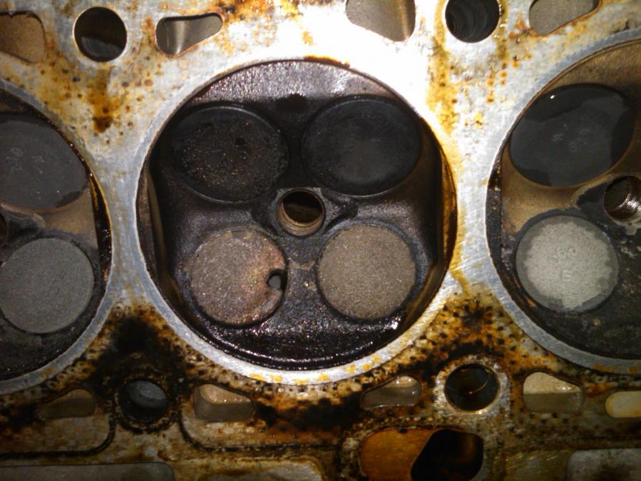

Old Jul 29, 2010 | 04:50 PM
1st time volvo owner's Avatar
Joined: Jul 2010
Posts: 10
From: Whittier, CA
yes it was the exhaust valve. Thanks for the info. I will post my progress every time I do something significant, I will also be asking for advice from time to time
Attached Thumbnails no compression on 4th cylinder from passenger side (7-month old post)-img00024-20100727-2023.jpg

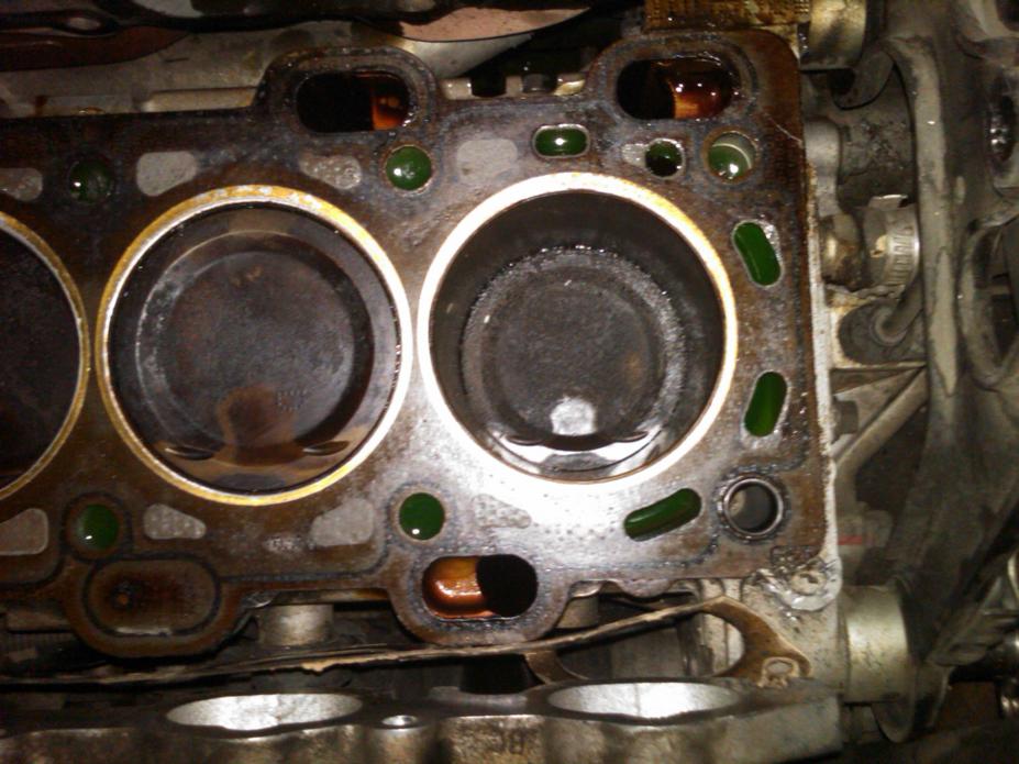

Old Jul 29, 2010 | 04:53 PM
Joined: Jul 2010
Posts: 10
From: Whittier, CA
This is the number 4 cylinder. I dont think this looks too bad, let me know what you think
