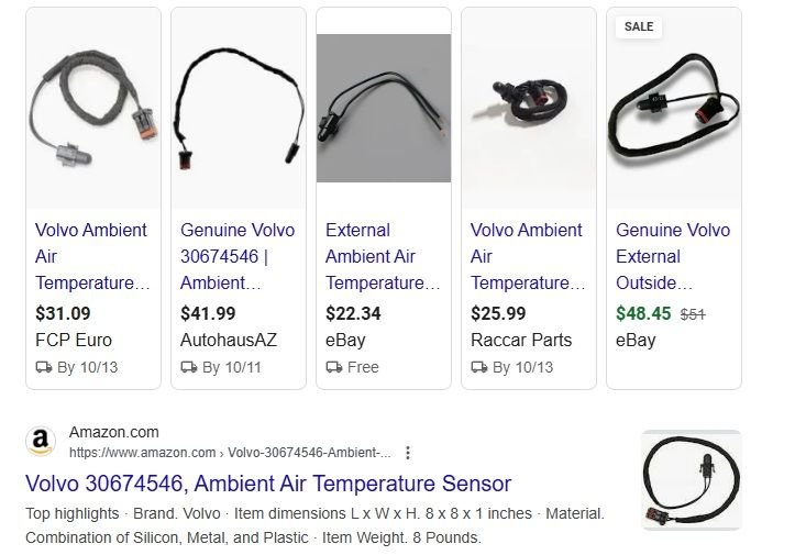

An xc90 of that vintage has a temp sensor in the outside mirrors. Those are used to tell the Engine management system and the climate system what the temp is outside. One possibility is the climate system won't blow cold if it thinks it's too cold outside. (I'm thinking it's the one that was just installed if ac was cold before and that was the only thing done) Either a poor connection or bad sensor - you could swap the old sensor from your old mirror if still available. (if the replacement one is sending the wrong signal) With a compatible scan tool you can see what that sensor is telling the ECU.
What's your outside air temp gauge on the dash showing? I suspect it's your /== indication you reported. Did the body shop provide and sell you the mirror? If so they would be responsible for not selling you a good used part. If you sourced the mirror yourself and gave it to them to install - the bad sensor is on you. (unless they did not plug it in properly - but that will be hard to prove)
