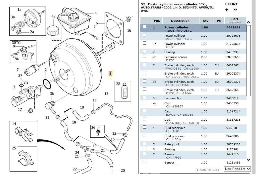

I have a 2001 Volvo V70
I am having trouble getting the correct Brake Master Cylinder.
The parts stores keep asking if it has Vehicle Dynamics Control (VDC) And Traction Control.
I do have the Traction Control button and
there is the W button (winter wet driving mode)
nothing tells me if I have VDC can I get help finding out what I have
Thank you in advance . Merle
There are 4 choices of #3 in the diagram. VIN and DSTC are the variables. Call your local dealer and with your VIN and they should be able to figure it out. Ask them for price, availability and part number. Then make your choice where you will source your replacement.
