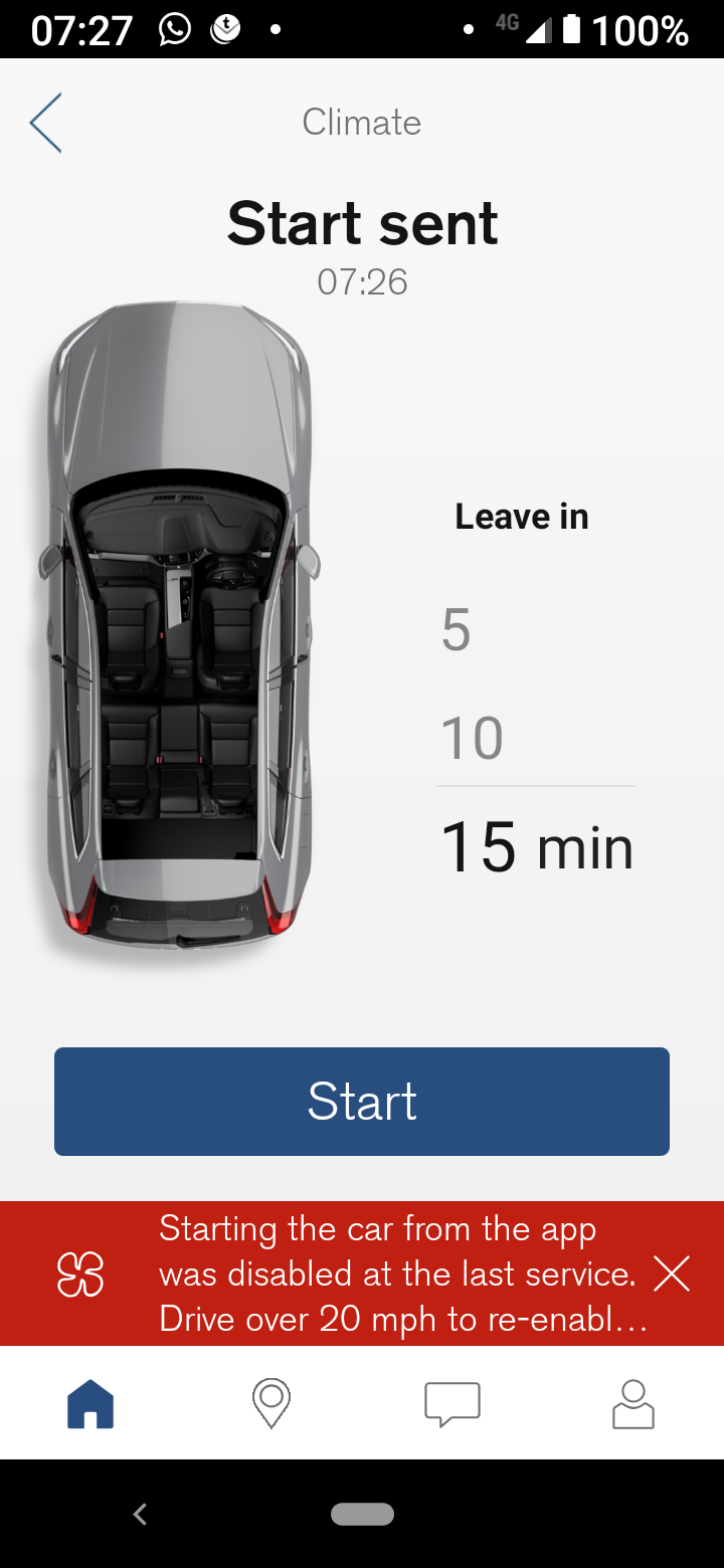

Hiya, join the club. My app was working for remote start, but this morning, the message was that the function had been disabled at the last service.....
Disabled remote start????

Jane, I hadn't gotten that message when trying and trying to use the remote start feature but I did last night. This app is worthless. It works sometimes, rarely, but not all the time. Frustrating thing is I have to believe Volvo knows this and is not working on a fix. Terrible. Car is only a 3 weeks old and living in MN we need a remote start. Thanks for your response.
