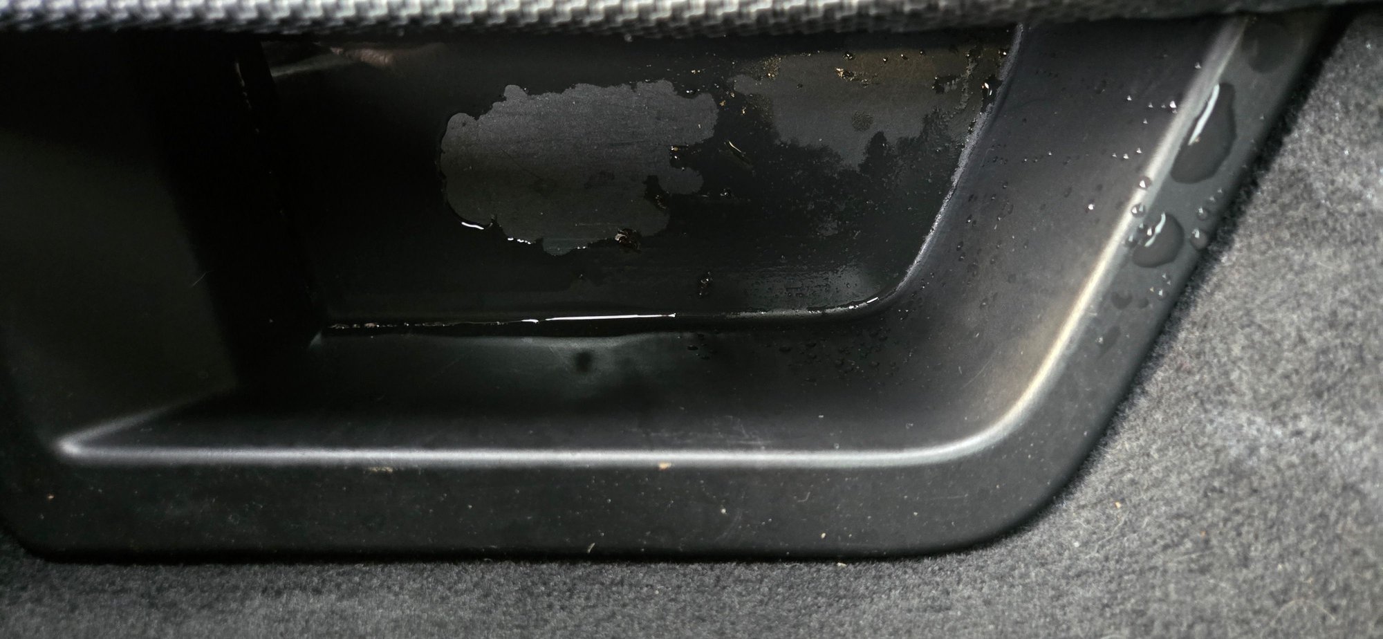

I just came back from a vacation and found the same thing on my 2016 xc90. My car had been parked slightly tilted on the driveway with the cargo being at the lowest point. Opened the car and noticed how everything inside was humid and water/moisture was dripping from the ceiling and windows, some water poured out when I opened the rear doors but the majority of the water was located in the trunk. The plastic compartment on the right side right above the fuse box was full of water, the compartment underneath the spare tire was full of water so I had to cut out the carpet/liner/foam in order to drain out the water and drain the liner. I do not know where the water got in so that I have to investigate but I’d appreciate if anyone had any tips! Also I found a rubber plug (drain?) underneath the spare tire after I cut out the lining, should this be remove so water can drain down that hole? See photo

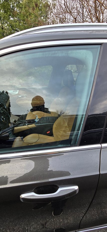

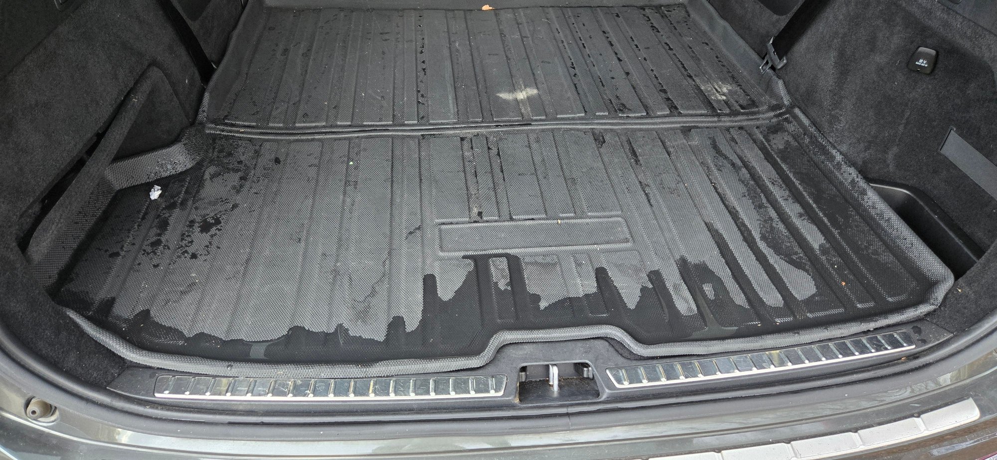

Recently, I too have noticed the same problem, but thought it was a leak at the windshield. I looked behind and saw the puddle of water on the rear mat. I'm searching the forum for a DIY repair, but may have to take it to CarMax for warranty repair.
The interior window is wet to the touch
I noticed condensation on the driver side window.
UPDATE! The dealership located the source of the leak to be the rear sunroof seal shrunk, causing a gap. That allowed debris to enter the sunroof track and clog the rear drains. Also, the stock rear drains were also pinched. The technician removed and replaces the rear sunroof seals, cleaned and greased the sunroof track, clear drains, and replaced rear sound traps and drain hoses. Finally, a dehumidifier was used to dry the interior. Total cost for the repair: $1516.
