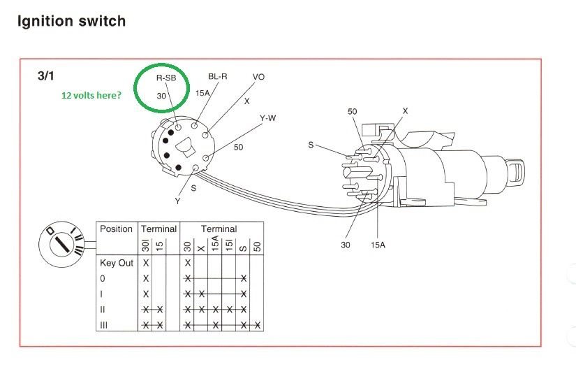

?? Undo the 2 screws and take the ignition switch off the steering column lock (switch pictured below) While still plugged in, Use a screwdriver to turn the ignition switch - electrical stuff should happen.

I already got the chip out it’s a glass tube with wire inside.
and when I turn with screwdriver and nothing happens then you think the switch is bad most likely?
Old Mar 23, 2024 | 07:36 AM
Do you have 12 (battery) volts at terminal 30? This diagram shows what terminals get power in what positions. Power gets to the red/black wire on terminal 30 from fuse 25 in the c fusebox (on the end of the dashboard) I've replaced many ignition switches (on earlier cars) for problems with the accessory circuit - but don't recall one that did nothing.
