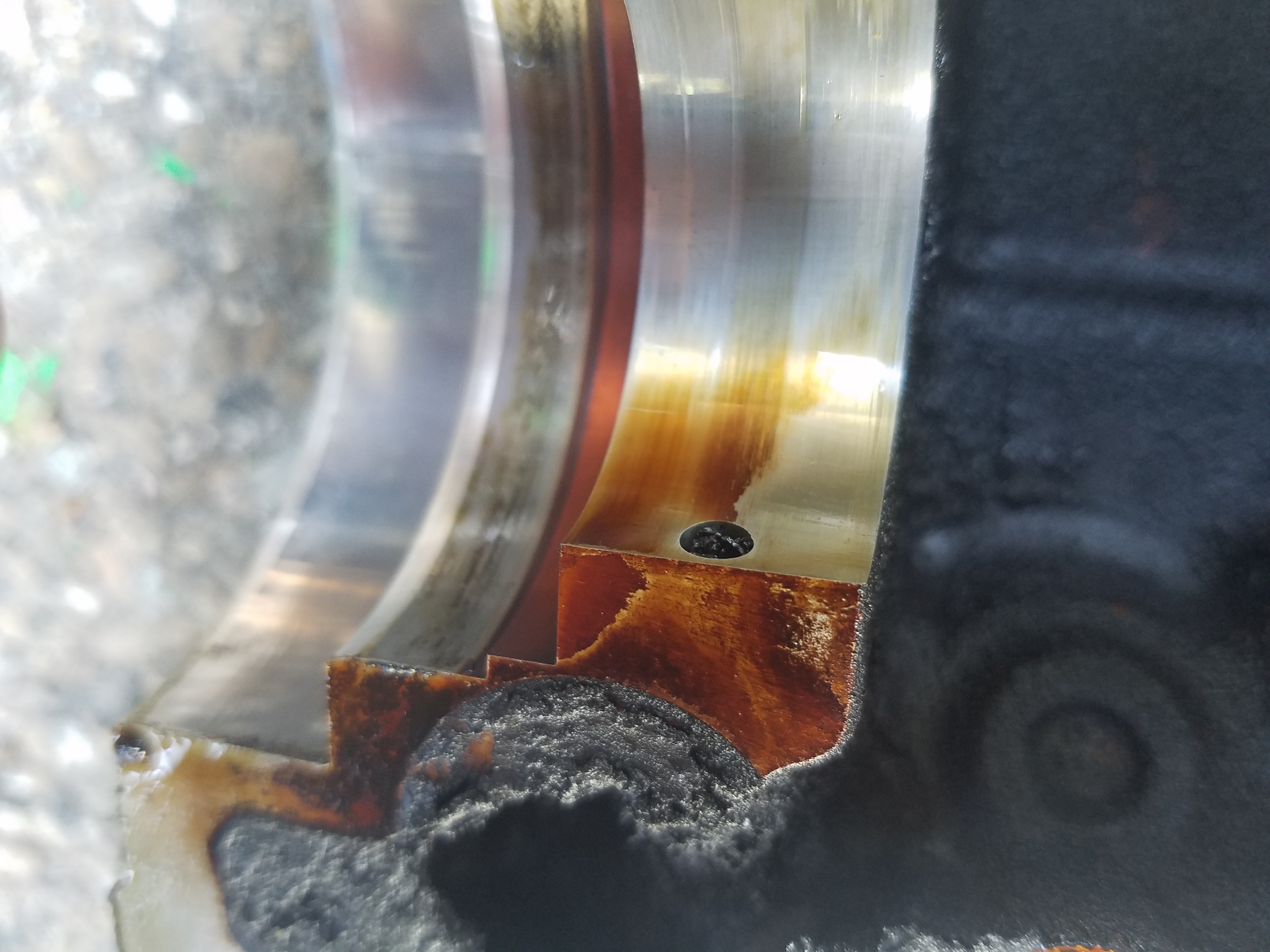

Thanks that number matches this engine. I pulled the cam cover. The cams and journals look good enough although i caught a clogged cam journal oil feed hole. The last journal to get oil on the intake cam (trans side of engine.) I figure I should drop the oil pan to have a gander as well....check the pickup tube and for sludge. Service the PCV system. The original engine died randomly when I floored it and I certainly don't want that to happen to the replacement engine. Any advice is appreciated. The engine is a B5254T2 2.5 5 cyl turbo in an 04 xc90 awd.
