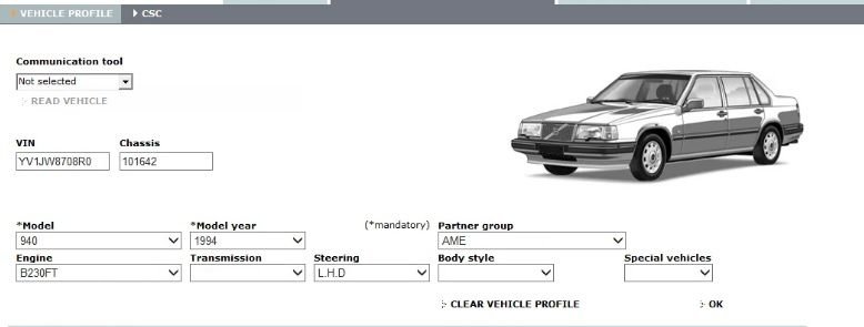

Here is the VIN:
YV1JW8708R0101642
Old Sep 21, 2022 | 01:39 PM
That car comes up as a north amercian 94 940 when the VIN in typed into the parts catalog. Does not specify then trans but the choices are aw71 and m90. What info do you need? No manual transmission parts are shown in the catalog - only automatics. Is it possible someone retrofitted a manual? And if so is it a m47 or a m90? (I've converted several Automatic Volvos to manual over the years, usually the hardest part is the clutch pedal)
