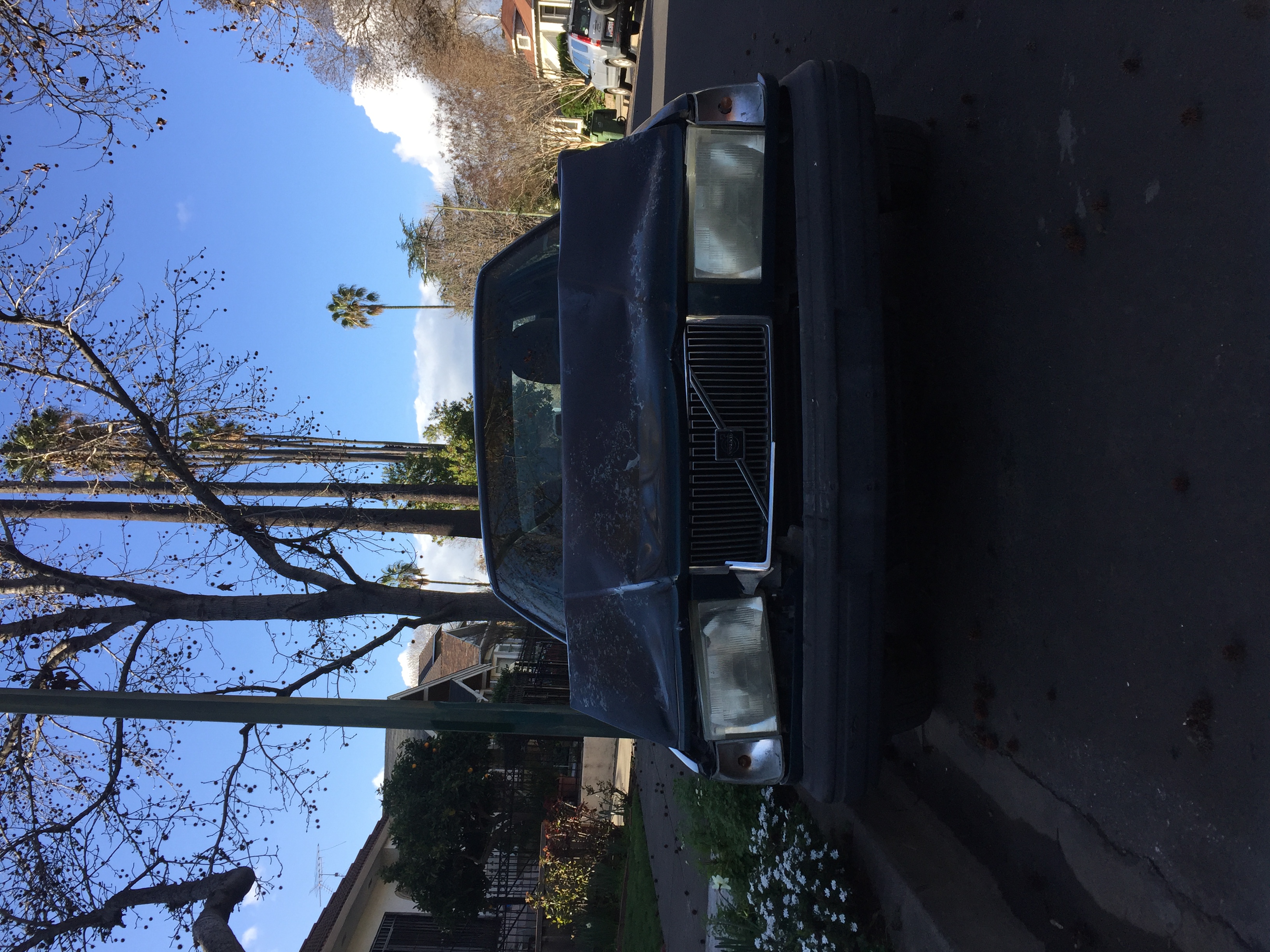

Would a 1994 940 wagon hood fit on a 1994 940 sedan? Lights grill and everything?got in a bit of a fender bender

there's two versions of the 940 front end, with or without integrated foglamps... if you change ALL the parts, then you should be able to switch between them. the 740/940 in my signature picture is the 'non-foglamp' version.
otherwise, um, wagon/sedan are exactly the same forward of the b-pillar.
