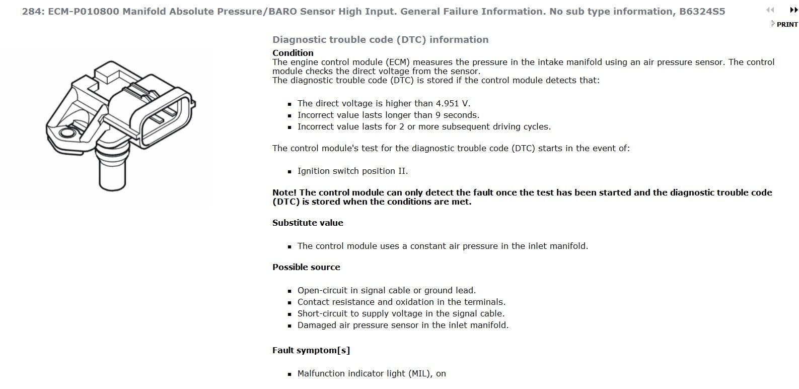

Rule #1. Diagnose then replace parts when proven bad. It can get very frustrating buying stuff you don't need. Note under "condition" - the sensor is tested when "ignition switch position 2. It is tested when the ignition is turned on - that's why it comes back every time you start the car.
