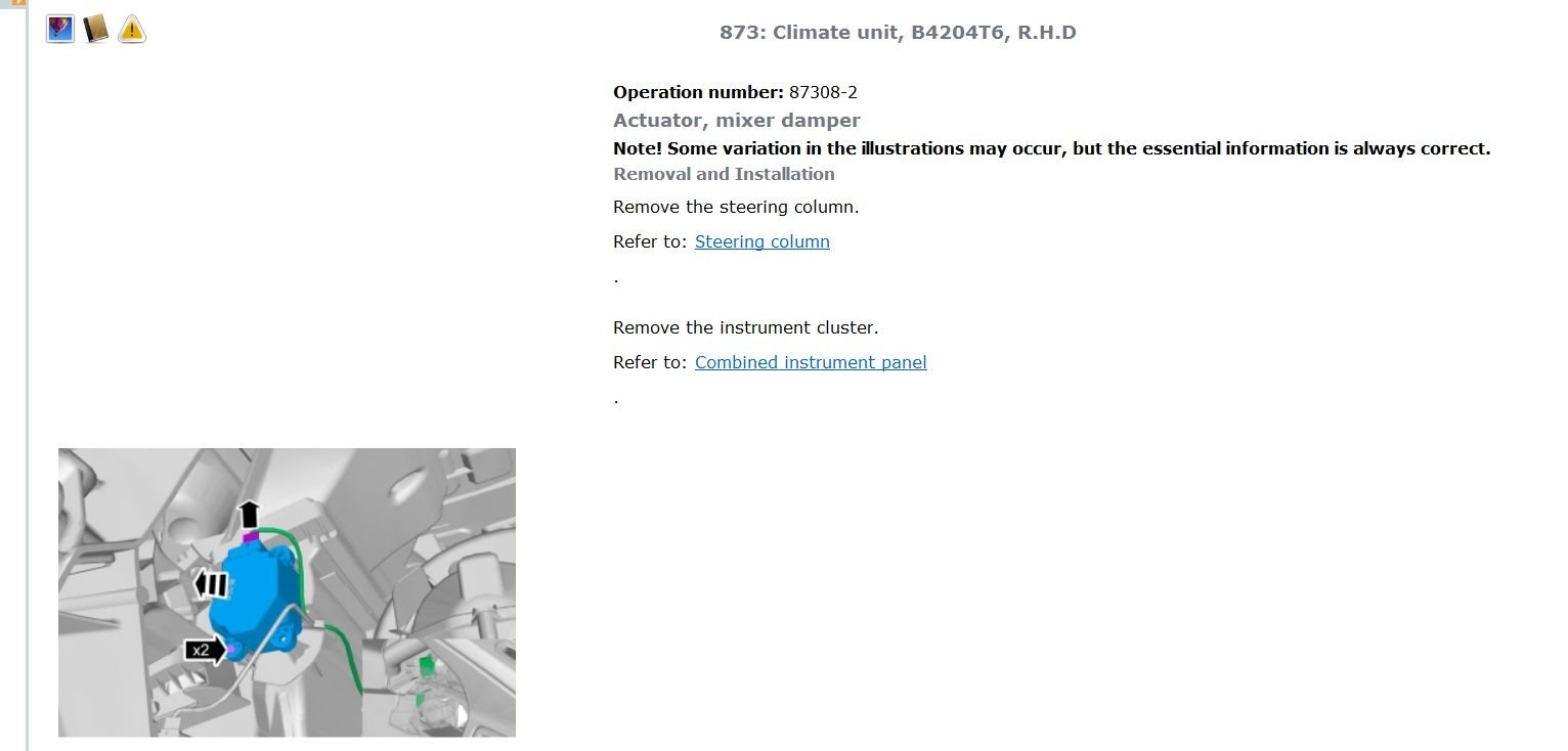

I have a 2010 V70 2.0. I suspect the drivers side air con actuator is away as it only blows cold on the drivers side (ice cold) whereas on the passenger side it blows both hot and cold air.
Going to replace the actuator, just wanted to know if there is a way to do this without removing the dash ?
Thanks
Old Jan 24, 2023 | 05:43 PM
Looks like you might be able to get to it by moving or removing the steering column as well the the instrument cluster. You can get to the passenger side by removing the glove box.
