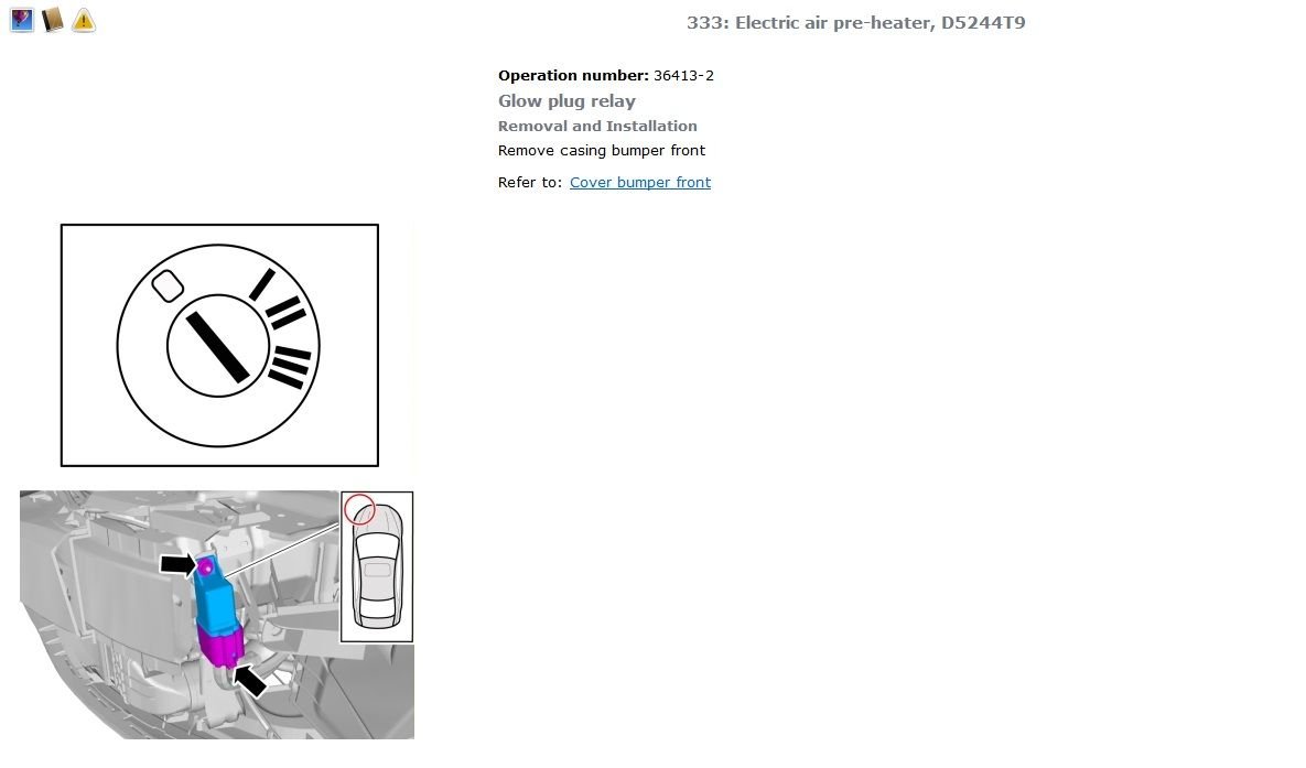

i have a problem with the glow plug relay ( computer says there is a fault) but we can not find the glow plug relay, it says its behind the bumper , had bumper
off no glow plug relay.
PLEASE DOES ANYONE KNOW WHERE IT IS HIDING

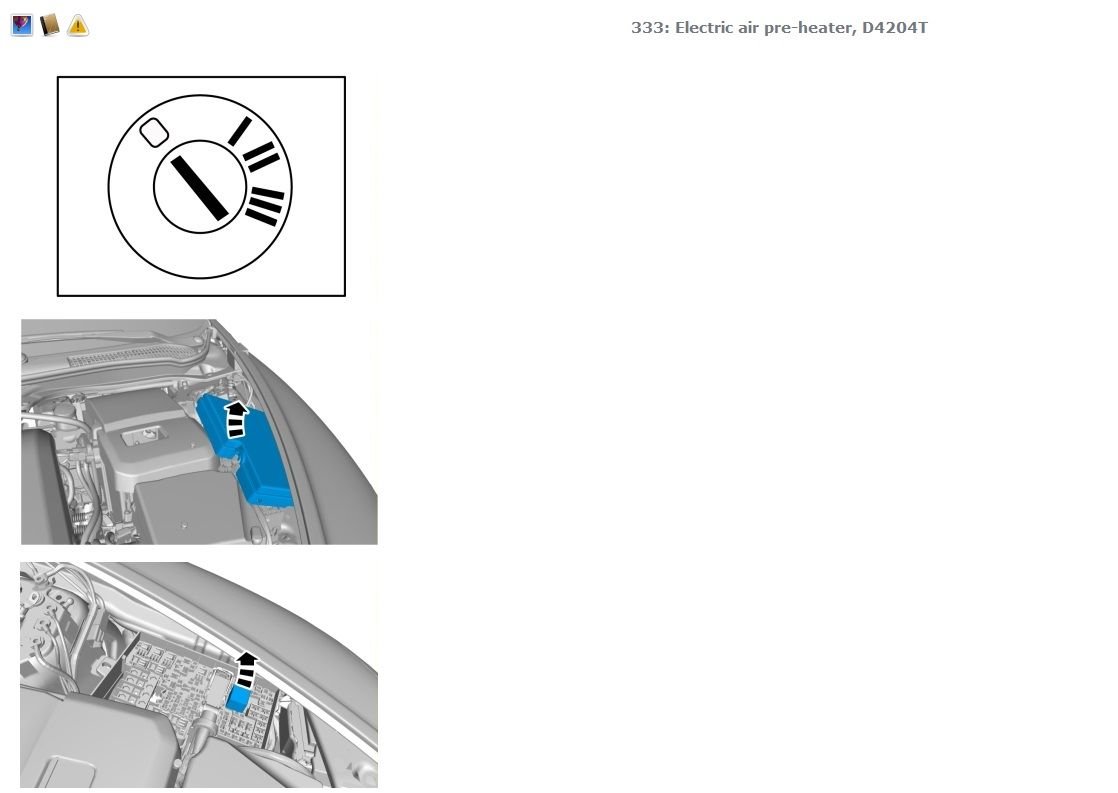

What engine? What's the VIN? - Here's 2 choices

So you have a D4204t. Diesel 4 cyl, 2.0 liter 4 valve Turbo.
That's the lower picture - relay is in the left side fuse box under the hood.

Thank you sooooooo much been out and looked and yes we have found it.
thank you
