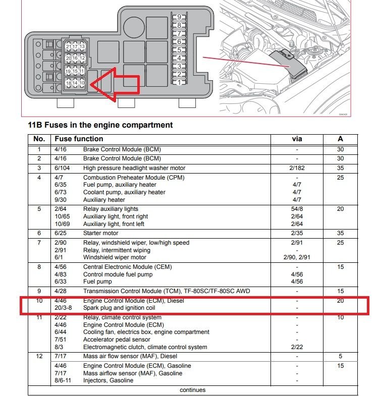

The starter will only engage if the shifter is in park (or neutral) and the brake pedal is depressed.
For an engine to run you need compression, spark (at the right time) and fuel (in the right amount). You think you have fuel and there's no common reason to have lost compression on that engine. (no timing belt) I have heard of on the Fomoco/Volvo/Landrover SI6 (but not seen myself) that if a coil melts and shorts out it will blow a fuse and prevent all the coils from working. Check your #10 fuse under the hood - If blown you might have a melted/shorted coil. (and technically if you didn't want to tow the car you could disconnect the melted coil, replace the fuse and drive on 5 cylinders. Would NOT recommend that - the catalytic converters will be destroyed)

I think you've convinced me that the problem could very likely be a burnt ignition coil. When I finally stopped the Volvo, I did detect a burnt smell. I'll get back to the car tomorrow evening where I'll check the #10 fuse as you suggested. Before I saw your last post, I had it in my mind based on your posts, that I will more likely have it towed into my mechanic for a diagnosis. I just started with this shop as I've only been in Massachusetts since September. Thanks for helping me think it through.
Old Dec 20, 2025 | 08:32 AM
brother0557's Avatar
Joined: Dec 2025
Posts: 7
Good day Hoonk... As it turned out, I followed your advice and it did turn out to be the #4 ignition coil that had burnt up along with the fuse. This is what I was told my the mechanic I started to use just recently. Prior to the breakdown, the Volvo was scheduled for a portion of the CAT assemblies to be replaced where it splits from the engine manifolds. After completion the Volvo runs well but I'm getting an engine light that Autozone scan showed failed cat codes P0420 and P0430 on each side. The mechanic suggests CatCleaner and a full tank of premium gas. I had the light come on back in August, thought about adding the cleaner as instructed but the light went out before taking that step. I left it alone. !600 miles from South Florida to Massachussetts and an additional 3k on top of that, so needed to get the problem fixed in order to keep the vehicle legally road worthy. I've read some negative things about this type of additives but Accel Automotive says adding it a long intervals with not do harm? It's great to have some peace of mind to discuss keeping my Volvo safely road worthy and legal. Cosmetically its in fantastic shape, and who can afford to buy anything new? So expensive these day. Thanks for reading through and I trust you thoughts and advice.
