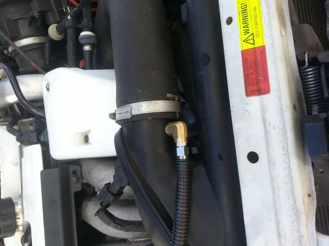

Thought id share some pics of my water injection install on my volvo, Taking my time and doing everything right and adding a few bits to my approval the install time was around 6hrs. I used the line coming from the windshield washer and put it into the water injection pump, my windshield washer is still functional. I put a check valve farther up to prevent the pump from sucking in air from the nozzles.

Sorry some of the pictures are sideways
