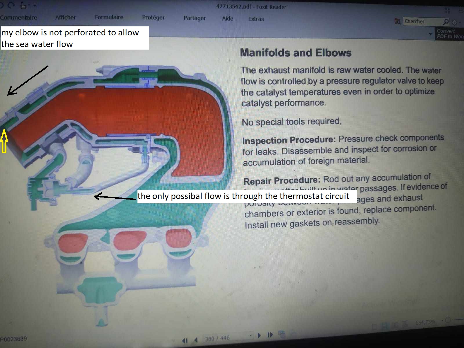

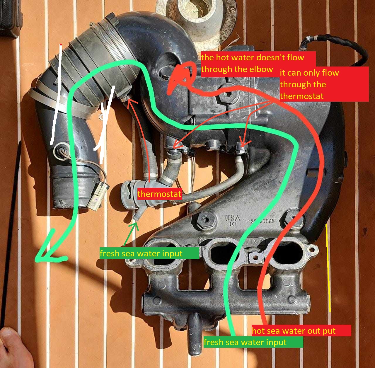

from your explanations ,I confirm that my engine is half closed .(the exhaust manifold and the exhaust elbow are cooled with sea water) .
let’s be clear , my engine has 01 thermostat behind the exchanger for the engine close circuit , and one in each elbows : total 03 .
probably my engine was destinated for very cold countries like Canada or Sweden , where the sea water is very cold (so the thermostat will open only when the engine is hot)
but what I can’t understand is that the elbow is not perforated in its tail as on usual exhausts seen on you tube .
the sea water remain inside the elbow and is evacuated , only when the water is hot but through the thermostat circuit not like all the other usual exhausts and as you perfectly explained : then the sea water after the heat exchanger goes to the exhaust manifold and then to the exhaust elbow and out with the exhaust. IN MY ELBOWS IT DOES NOT GO OUT DIRECTLY WITH THE EXHAUST .
My question is : have you ever heard about elbows that are not perforated to keep the water flow (see attached the green flow ).
If my elbows due to excess of heat (my country is hot ) has fissurated because they are not well cooled with sea water in permanence , this will PROBABLY explain the presence of water in my plugs
thanks
sami

Almost guaranteed some sea water is flowing into and mixing with the exhaust all the time. Otherwise the rubber exhaust would melt. It may recycle some to keep the manifold around the catalytic converter at operating temp. But some goes out all the time.
You are absolutely right .
I think I have a catalytic elbow that needs to go to high temperature before being cooled .
But if it becomes hotter than required , will this damage the exhaust and make cracks that will cause sea water to leak????
One thing to keep in mind is all the water pumped by the sea water pump leaves your engine. If you sea water pumps 5 gom then 5 gpm is leaving your engine (5 gom is an example only). What may change is the ration of water being recirculated vs going straight out.

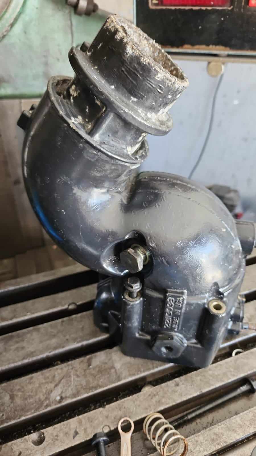

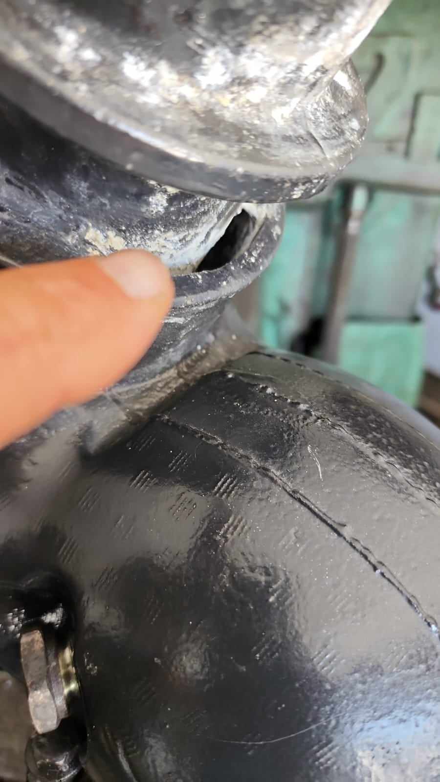

Hi
Yesterday we controlled the exhauster and verified that it is in a good state.
After a discussion on a forum in Facebook, I finally understood, that the problem of water in the plugs , is due to a known phenomenon : EXHAUST REVERSION .
It is a conception default on the volvo penta V6 280 N, that sometimes and RANDOMLY makes the water SUCKED backward, instead of being expulsed with the exhaust .
It is exactly the same problem than last year sudden stop.
The local agent of Volvo refused to apply for the warranty, because they considered that the water that entered the pistons, was due to my bad sailing behavior :wrong backward movement.
Now that I know that the problem is not due to my fault , I will ask for a compensation.
