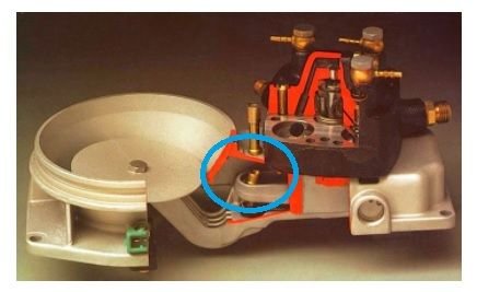

also, I can’t locate the fuel mix adjustment (using the allen wrench). I was shown where it was several years ago, but I am having difficulty now. Do you have suggestions on its location (I believe that it is towards the back).
You don't have a "carburetor" - and if your trusted mechanic thinks you have one ------ You have K-jetronic fuel injection. Was used by many manufacturers in the 70's. Probably not many people know how to fix them that are still alive!
Don't remove the rubber boot unless absolutely necessary. It will tear. They are still available and don't cost a bunch but - there's no reason to take it off unless you are replacing something big.
I would make sure all the basics are perfect before touching the fuel injection system. All ignition stuff, compression is ok, no air leaks, that kind of thing. After that if the idle is rough the injectors might not be firing properly - as in not spraying the same amount of fuel to each injector at low openings. That's why I suggested laying the injectors on the valve cover and with fuel pumps running push the fuel metering plate up from the bottom with a suitable bent tool and examine the spray pattern of each injector. I'd bet the 4 injectors will have 4 different patterns at a simulated low air volume (plate not pushed up very much) Dribbles, drips, perfect cone, and wild spray in different directions. The goal is a perfect cone. Push the plate up as high as you can - sometimes that "clears" the injectors and produces better spray patterns. Sometimes you have to replace or somehow clean the injectors. Sometimes it's not the injectors - the fuel distributor is the problem. Once you have 4 injectors with good spray patterns - and there's the proper air getting in through the throttle plate - then you can adjust the fuel mixture if needed. Although without a exhaust gas analyzer to be able to tell what and how much you are changing - you will have to rely on your knowledge from adjusting carb mixture and fuel injection systems in the past - to know if what you are adjusting is helping or not.
The fuel mixture adjustment is located down the hole between the boot and the fuel distributor.
Here's a diagram of where the mixture adjustment screw is. It adjusts the angle of the air metering plate with the piston in the fuel distributor. There's no plug/cap over the hole as shown- Volvo never used one. Pictured also is a 3mm allen wrench - a regular T handle wont fit, you have to cut one side of the T off and shorten it to fit in the space available.
