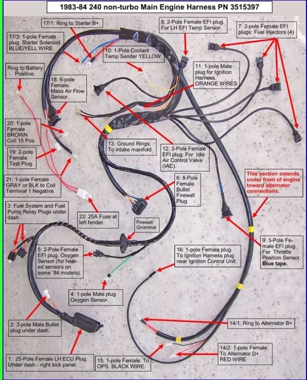

1983/84 had a really bad engine wiring harness. We replaced many on cars less than 15 years old. Wires rub together and all sorts of weird things happen - (there's wiring to the starter/alternator in the same harness with the injector wires) When was yours replaced?

I'm not suggesting even touching your wiring harness - it is a problem I saw many times fixing Volvos. The 83-84s seem to be the worst with the insulation falling apart.
Your engine wiring harness has been baked into a solid mass. (the plastic sheathing becomes hard and brittle) After about 15 years the only way to get them off the engine was with wire cutters.
So - no, do not try to remove the harness. (if you do it will be destroyed)
Replacing it - is there a replacement available? There were aftermarket solutions a few years ago - but that kind of thing is usually very expensive. The factory harness was close to $1000 when it was available.
This guy might have a solution if you need a harness.
https://www.prancingmoose.com/volvoh..._240_non-turbo

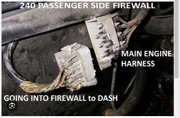

The insulation on the wires in the plug shown below is usually the first to fail - what do those wires in your car look like? (plug is above the cam cover)

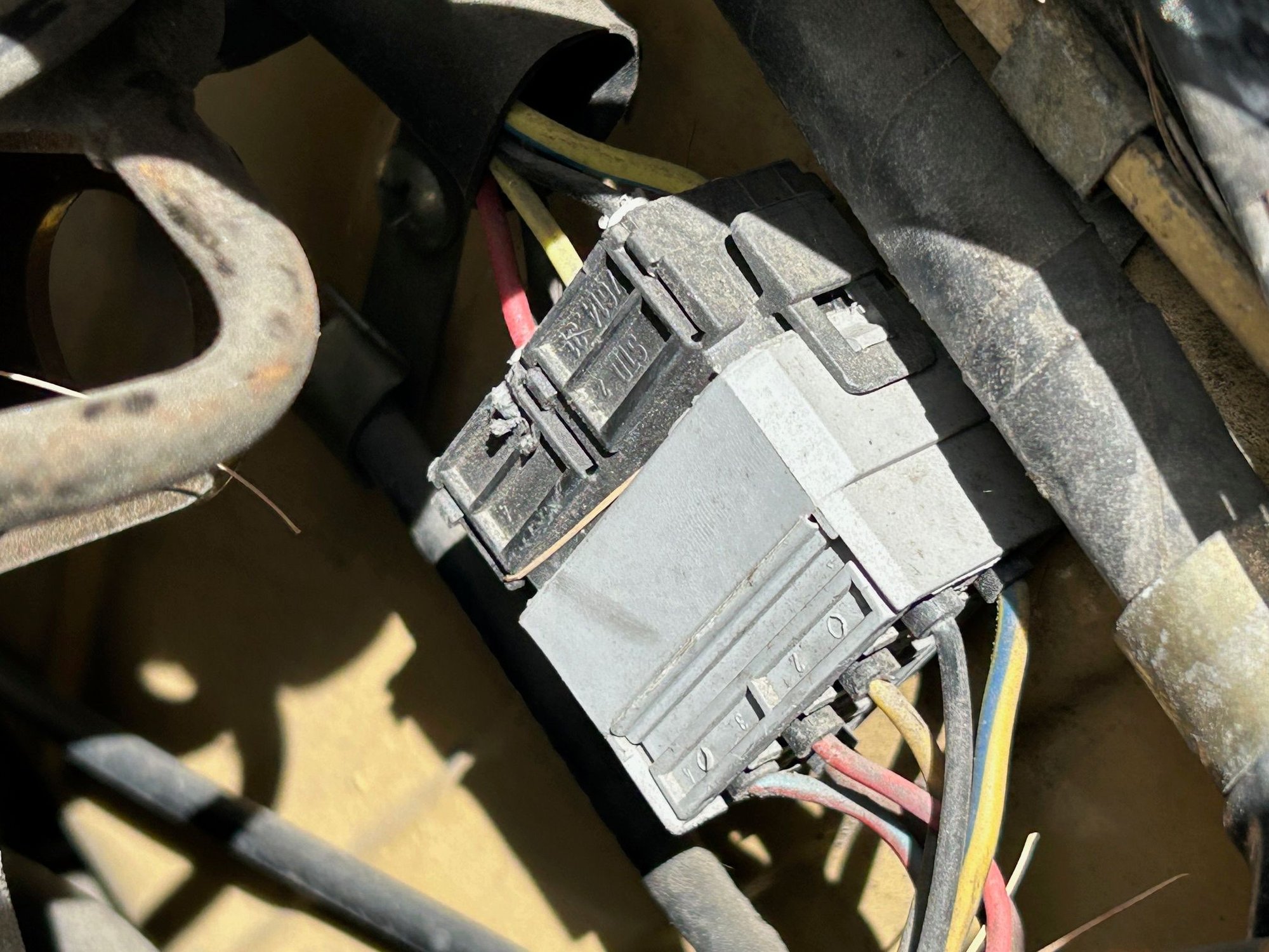

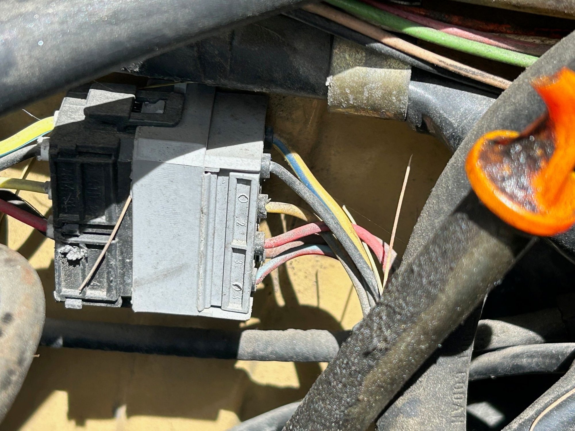

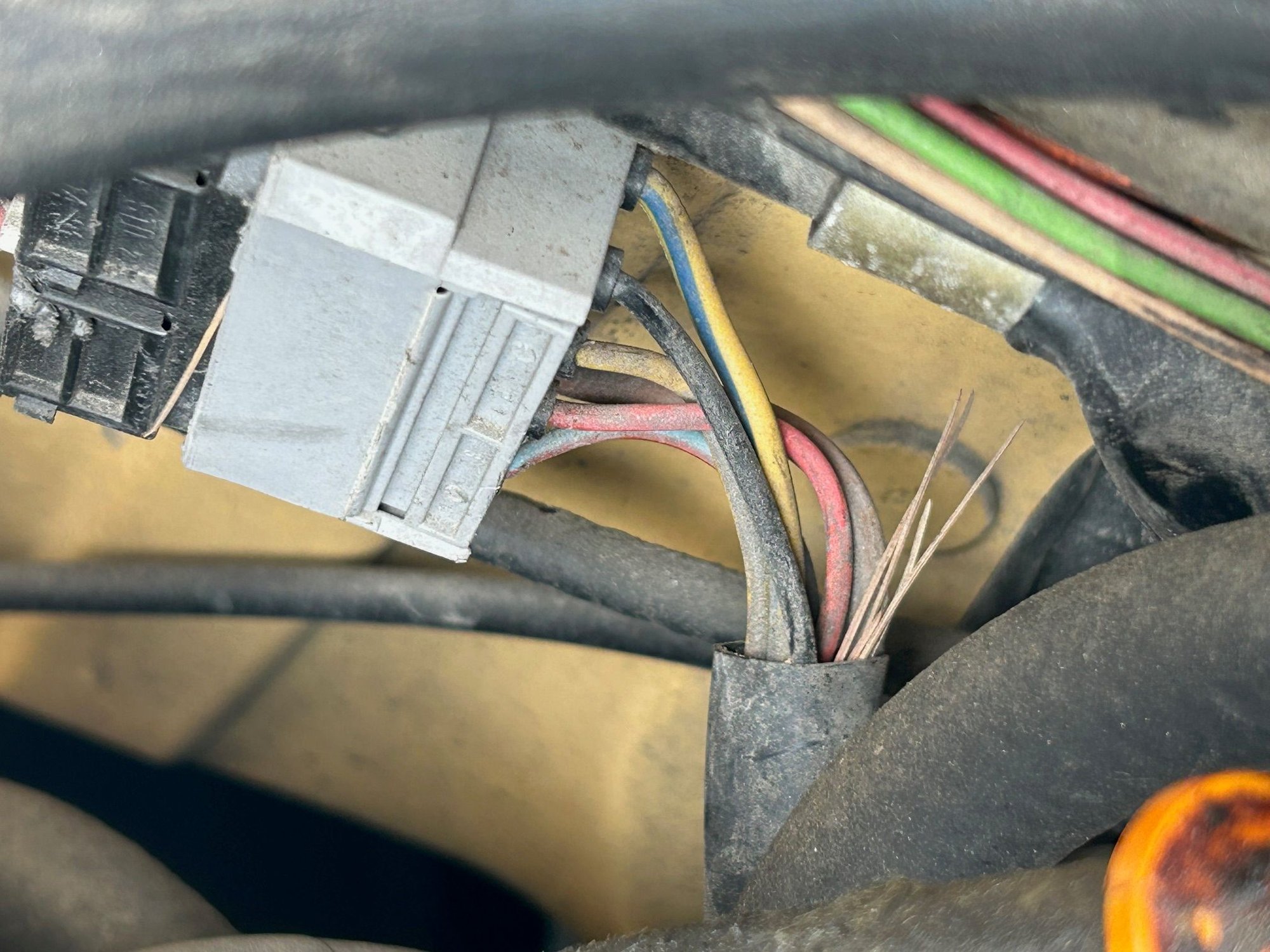

I stopped by the shop yesterday and took these photos of the main engine wiring harness at the connector. The insulation on the wires looks pretty intact to me. I did not detach the connector or try to peer into the plastic covering that holds all the wires together on each side. I guess it's a possibility that the pins in the plug (or some of them) are not making a good electrical connection.
Old Aug 19, 2025 | 07:23 AM
Looks like that harness has been replaced. I thought the factor harness had a grey plug on it - your looks black. Those wires are for the alt light, temp gauge, oil light and a couple of other things - The fuel injection wires are in the harness also - but terminate at the control unit in the rf passenger compartment and protected from the environment. .
