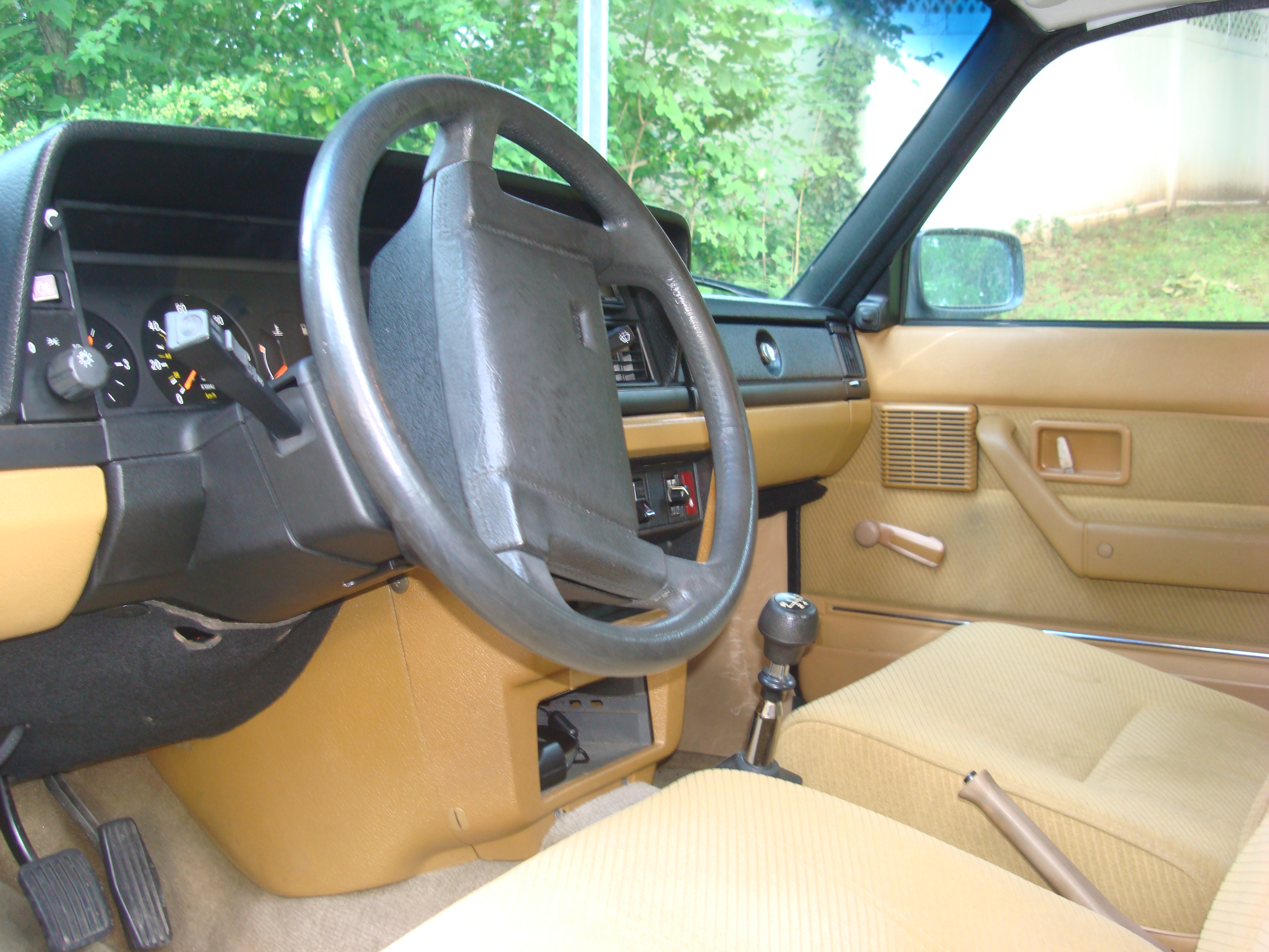

Back at the end of April my Volvo’s engine threw a rod after 289,000 miles, so obviously I can no longer drive the vehicle. As you can see from the pictures, it’s an absolutely beautiful car but it won’t move an inch. Chances are, I’ve got a loose rod or piston in the engine but I haven’t had my mechanic verify that. I’m confident in saying that’s the problem because my mechanic suspected a loose rod and/or piston once I specifically described how the car started losing power and then wouldn’t restart after I turned it off.
This 240 has quite a bit of sentimental value to say the least. My parents bought this car when they were planning on having me and I came home from the hospital in it. This is the 1st car I learned to drive on (and drive stick shift) and I took it to high school every day of senior year. In college, I drove this Volvo 500 miles to and from home a couple times a year. To say the least, this vehicle was my girlfriend before I had a girlfriend.
Besides the engine (which is really the most important part), this car is in impeccable shape. The clutch has plenty of life left and the timing belt was just replaced back in December. The AC system was completely overhauled from R12 to R134 5 years ago and the fuel pump is less than 2 years old. The car has plenty of life left if only it had a working engine.
