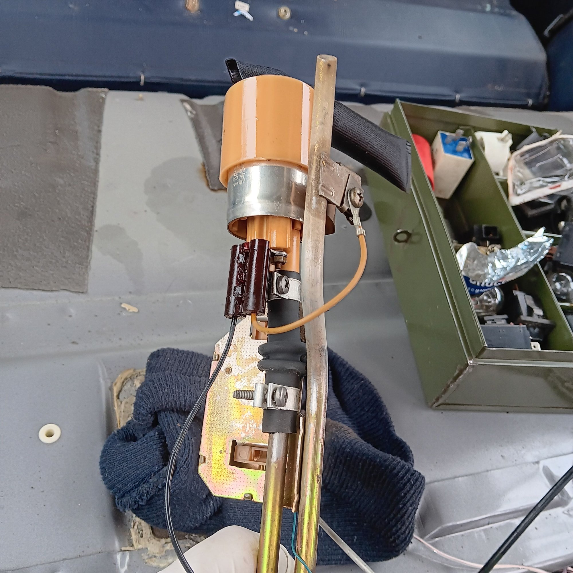

So I changed the fuel filter and bench tested the in-line fuel pump. It seemed to work fine so I put it back on with the filter. Still no start. I also listened to the tank pump with a tube while the pumps were turned on by fuse panel bridge. Also humming. i was confused so I hired a mechanic friend to help me diagnose it. We couldn't do a fuel pressure test but he sprayed starter fluid into the throttle body and it started and died. So he had me crank it again and this time he sprayed it in and kept spraying it and it kept running as long as he sprayed it, for like a minute! Then as soon as he let off it died again. So he says it's for certain the fuel pumps.
I bought a delphi.pump that's supposed to fit, but requires cutting the wires and changing the connectors. I'm not really fond of this idea. Might just toss it and order a bosch since I have to wait a week for the new lift pump anyway.
Should I replace the entire fuel sending unit or just the lift pump? I've been humbled by this experience.
​​​​​Is there anything else I should do? My friend is a pro but not a volvo mechanic. He works at a BMW/VW/Audi shop.
Let me know what you guys think. Thanks I appreciate your input.

Okay so I replaced the in-tank pump. Bench tested the old one and it seems fine, though the sock was deteriorated a bit. Car still won't start. I've verified the relay is working and that the pump is getting power, (though only 10.8v when the battery is at 12v.)
​​​​​Since the 1988 doesn't prime, do I need to do something to get fuel back in the line? I also replaced the fuel filter and bench tested the original in-line pump which emptied it. I did force start the fuel pumps again at the relay which I would assume would send fuel into the system. But maybe there's something else I'm supposed to do. Either that or there's some other mystery problem. The engine is not getting fuel and I can't understand why. Could it be a stuck check valve?
Appreciate your input.
