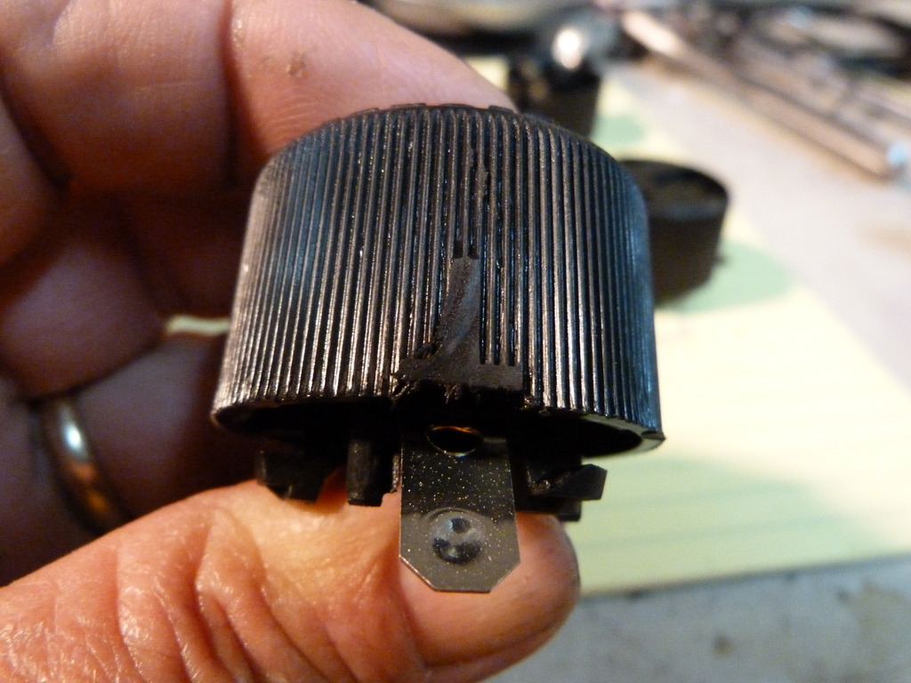

Then cut the tabs off the lamp holders and bent the tabs down to solder them.

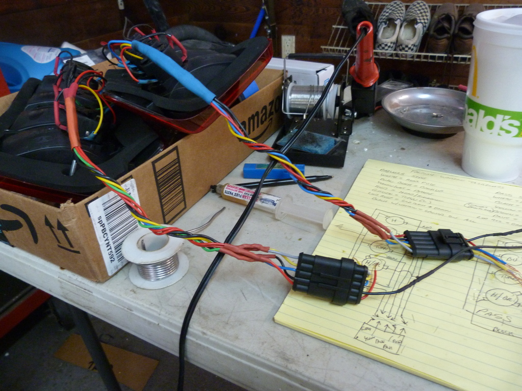

Installed in the housing and added the 5 wire connectors:
Now for some late night wiring adventures....................

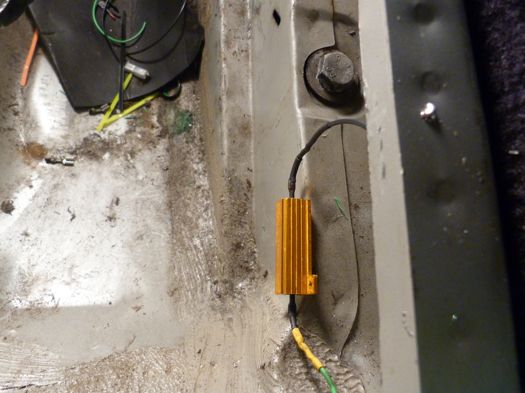

Hard mounted the resistors to the body and attached to the ground point:

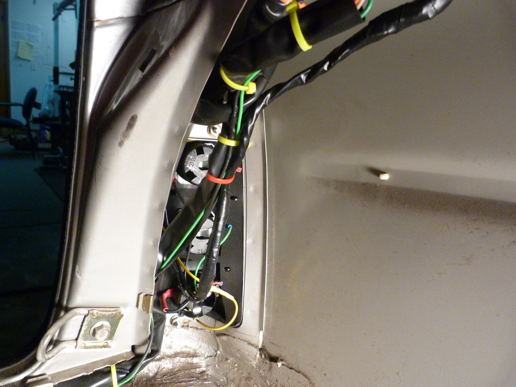

Attached the factory light signal wires, the resistors and the chassis ground to the other side of the 5 wire plug:
All tied up and ready to go:
Put it all back together and tested the lights..............Wow! They are bright as can be and look great. The turn signal resistors work like a champ, I also changed the front turn signals to LEDs.
