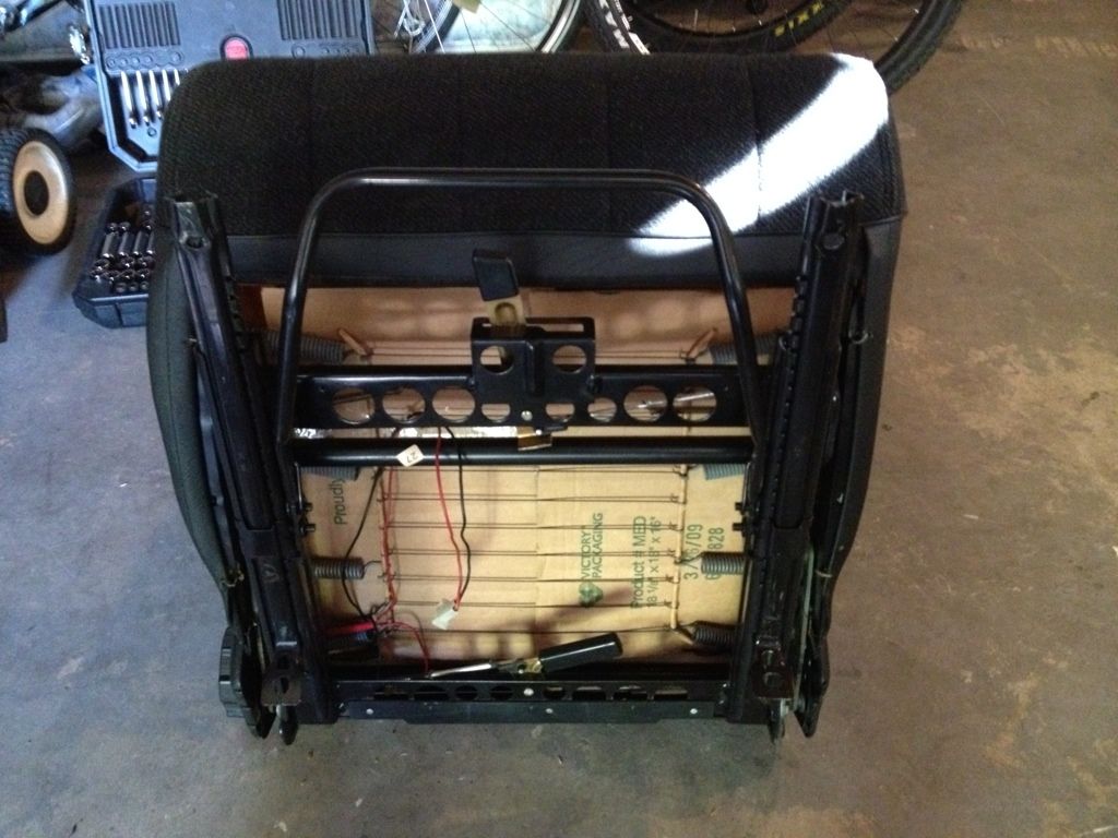

since the driver seat foam was so crumbly, I decided to see if I could fix it. the seat was missing 2 springs (which was also why it sucked so much), and the foam was crumbling through and around the springs that were there...also, the heating element was broken in many places. foam everywhere. so I decided to cut some cardboard and slide it between the cushion and the springs to stop it from getting crap everywhere and to stop the springs from cutting up into the foam more.
I also moved some of the springs around to space them out better, and I had to combine two smaller ones to make a janky "longer" spring since I was missing one.
I did the same with the passenger seat, but there was very little damage to the bottom and no springs missing. preventative maintenance...
instead of swapping the cushions and backs, I decided to risk it and just swap the slider brackets and see if they would fit. I swapped them and cleaned them up. then test fit the driver side.
the recline wheel is pushed hard against the plastic cover for the ebrake, but it can still be turned. I don't really recline the seat ever, and since I'm the only one who drives this car, sliding the seat forward will probably never happen.
so I cleaned up both seats and put them both back in. everything fits, just a tight fit on the recline wheel is all...swapping the brackets was easy and after it was all said and done, I only spend about 3 hours total on the project. I could probably do it in less than an hour now that I know what I'm doing.
the new seat feels great, and actually, so does the other one, now that I "fixed" the spring situation...probably could have lived with just fixing the springs and not doing the swap, but oh well.
