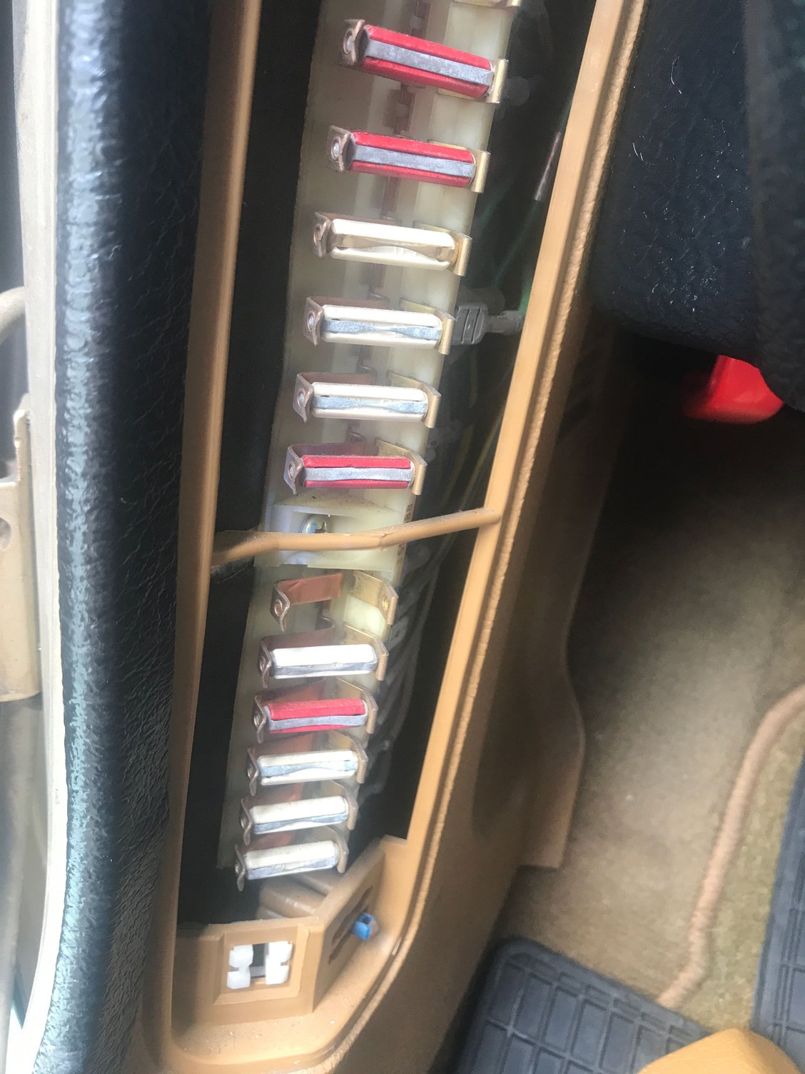

Old Mar 22, 2020 | 02:45 PM
michaeldiaz94520@hotmail.com's Avatar
Joined: Mar 2020
Default Fuse popped
The min I turned the key on after replacing red fuse it popped. What now ?
Old Mar 22, 2020 | 02:47 PM
Joined: Mar 2020
Default Fuse
Red fuse popped
Missing spot is where red fuse popped
Old Mar 22, 2020 | 03:18 PM
well, that means there's a short to ground on that circuit. not sure off the top of my head what fuse that is, or what it powers.
Old Mar 22, 2020 | 03:22 PM
if thats fuse 11, random google searches suggest thats the transmission overdrive relay, and the seat heaters (if any).

On the inside of the fuse cover plate it says what each fuse is for.
