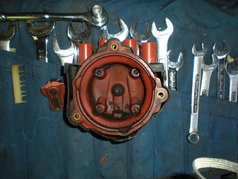

Speaking of caps, I did plugs (Bosh 7900) wires and cap this afternoon on my new 940. the car was running OK just a little detonation over 70 mph. as you can see the rotor required a little persuasion. BTW where did remnant of the washer like thing in the cap come from? I can't see anything back there.
Judging by the oil mist inside that cap, I would hazard a guess at that "washer" being the remains of an o ring or seal.
