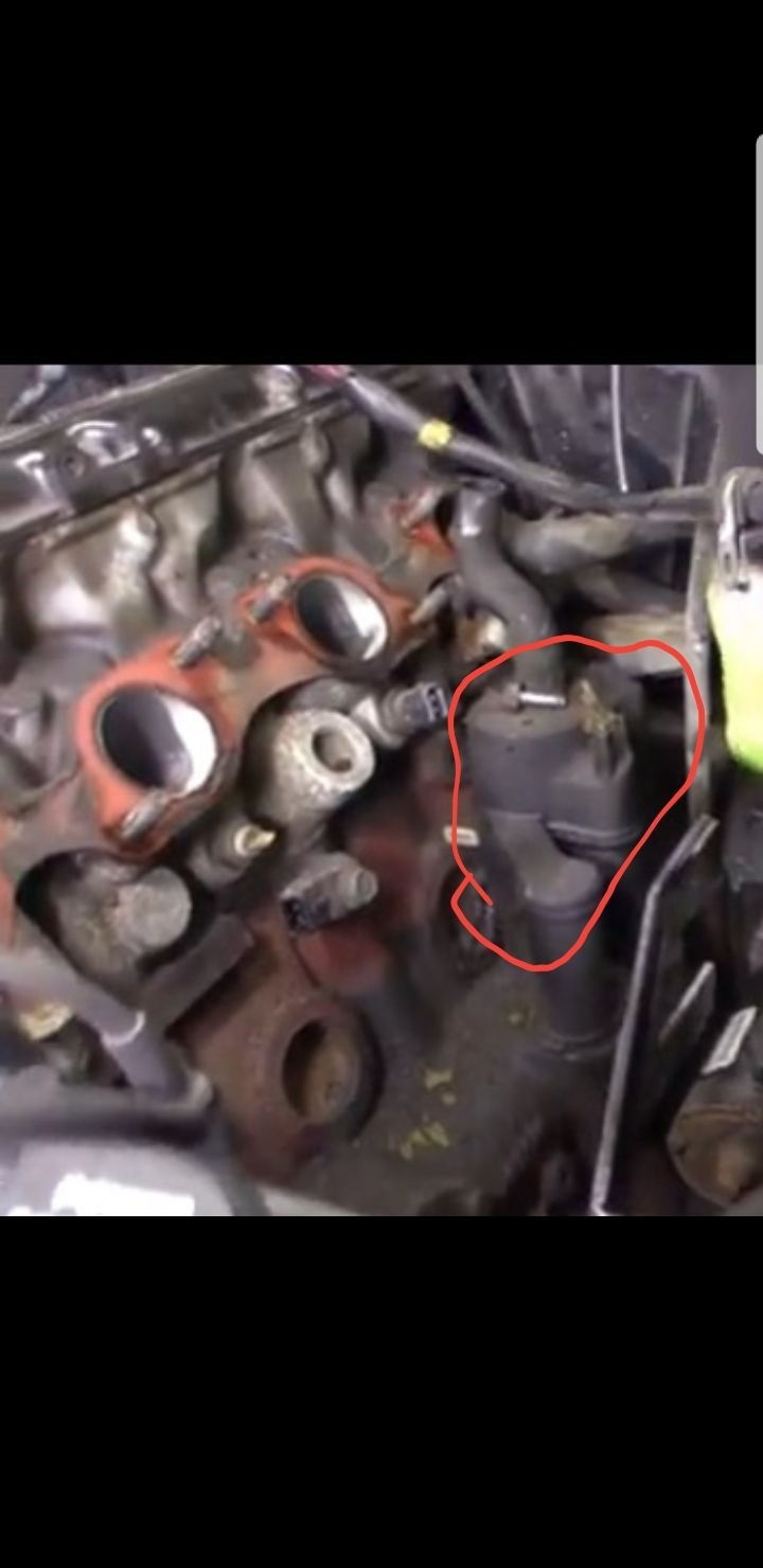

I did test the fuel injectors, couldnt find the exact resistance but they all have the exact same resistance, I do think my fuel pressure regulator was leaking and that's what caused the gas in the air intake, because before replacing I could smell gas heavy, after replacing I do not smell gas.i also found an oil leak here (this is not my vehicle, was just looking for a picture of where the oil was leaking from it seems to have a slight gap on the top of it so I will need to get to it and replace it.

There seems be a pretty big gap in the seal of the oil seperator, also where the oil is leaking out could this possibly cause other problems or be the cause of oil being on my spark plugs

Now that I think about it it wasnt much and could it be coming back from my air intake end because there was a good amount of gas left in the part before the maf connected to the throttle body .
