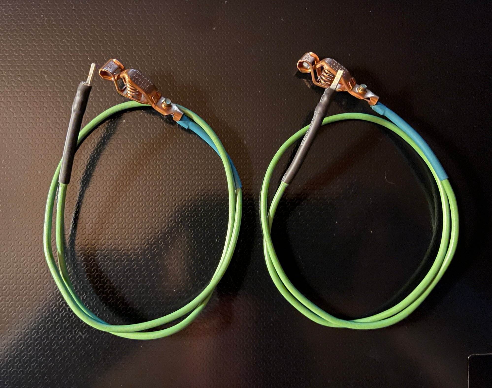

Made a couple of test leads today to complete the task!
