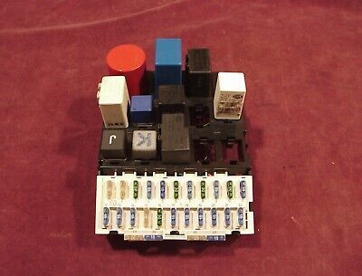

Originally Posted by swiftjustice44
There is no alternate location to the best of my knowledge. It sounds like someone got creative in the last 16 years! The relay is white, rectangular and has, I believe 6 pins. There may have been a problem with the fuse panel melting and they wired around some how. The fuse panel will actually pull forward and allow you to see if there has been some re-wiring done underneath. I doubt the relay is too far away.
((d|-(<O>-| |-(<O>-|b)) ®....... ® /,|<0> | <0>|,\
I have the same problem, with starting and then not starting, on my red 940.
I looked at the relay block, and no white 6 pin there, as shown in picture above, for TURBO MODELS...
I have 2 1994 940s, non have it.. There is the space for it, but no wiring pins in the socket...
P/S There is no burnt panel or wiring.....Both are empty....Will take Pics of mine, soon.
I

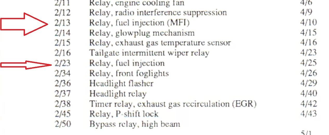

The turbo cars use a white relay in the position shown in your photo. The non turbo cars both bosch and regina use a fuel pump relay labeled 2/23 in the position shown below.
Thanks! I wanted to make sure it was 2/13, Not the 6Pin for turbos....That is the right one for THE NON TURBOS. I found out the hard way, and bought 2 Turbo F Pump relays.., Sellers on eBay should state, that they are for TURBO models. I also have only a fuel filter, [ Not a fuel filter and pump], in the middle of the Car. What pimp is recommended, for the TANK pump..
