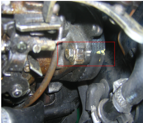

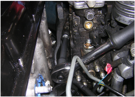

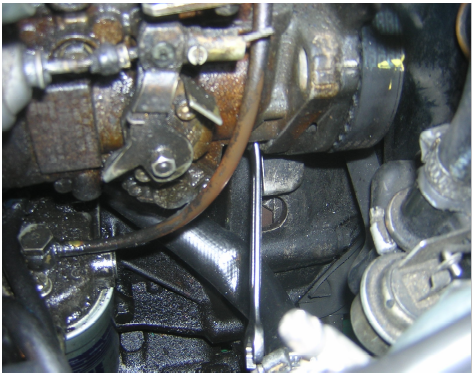

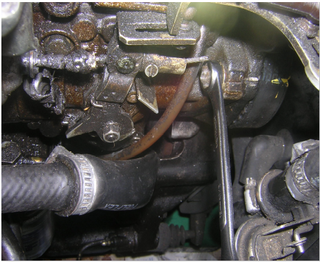

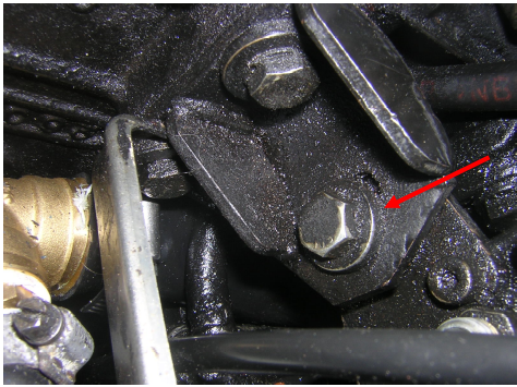

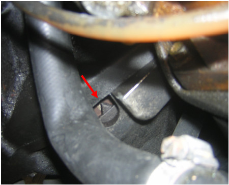

So here is what I did just in case it can help.
Lifted rear of the car, 4th gear set, turned rear wheels by hand, until :
Crankshaft set to 0 position
Carves on pump mountings - pump body and "V" mark on pulley "more or less" aligned
Released bolt #1 (13mm)
Relseased bolt #2 (13mm)
Released bolt #3 (this one is facing front)
And relased last Allen 6mm screw (tricky need extension)
Then I started the engine ad moved the pump on its mountings until I coul hear a nice idle then fastened #1,#2, etc.
Smooth acceleration, and what I'm REALLY happy with is : no more white smoke at ignition !
It's a gaugeless method that worked for me.
