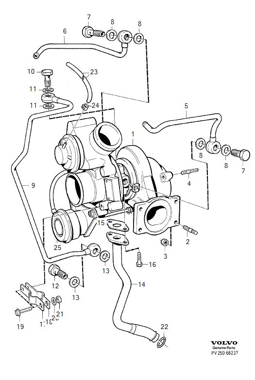

if it was the internal seals, the oil would be in the exhaust as massive clouds of blue smoke. oil on the outside of the turbo is more likely from the oil plumbing to the turbo.
here's the turbo plumbing on the mitsubishi used on late model 940 T's... #5 and #6 are coolant pipes, while the oil comes from #9 and exits #14 hint, if you take this apart, be sure to have new gaskets on hand.

first I'd do is spray it down with foaming engine cleaner, brush it with a parts brush, hose it off, repeat if its still nasty, then run it for a short bit and look where the oil is coming from.
the connector on top of the turbo bearing is the pressurized oil being pumped into the bearing, the pipe on the bottom goes to the crankcase to return the oil, so the first thing I'd check would be that banjo fitting 10 right on top.
