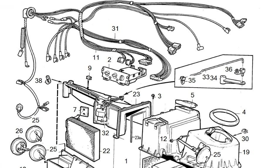

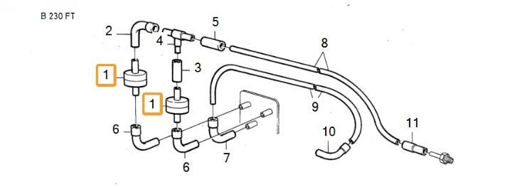

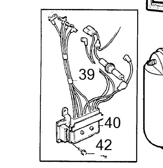

If you have ECC (climate control) You have vacuum to 2 of the ports on the firewall as pictured below? 1 port goes to the vacuum controller in 2nd picture, 1 port goes to the temp sensor in the dome light, and the 3rd port sends vacuum back out to turn the heater valve on and off.
Find the other side of that port plate on the firewall - and trace it back to the vacuum controller. Probably a collapsed vacuum line. Aren't they color coded? Or do you have MCC (manual climate control)? 2 Vacuum lines enter on the left side of the firewall on those. (3rd picture) 1 for the heater valve and the other for vacuum to the controller built into the control panel. .
