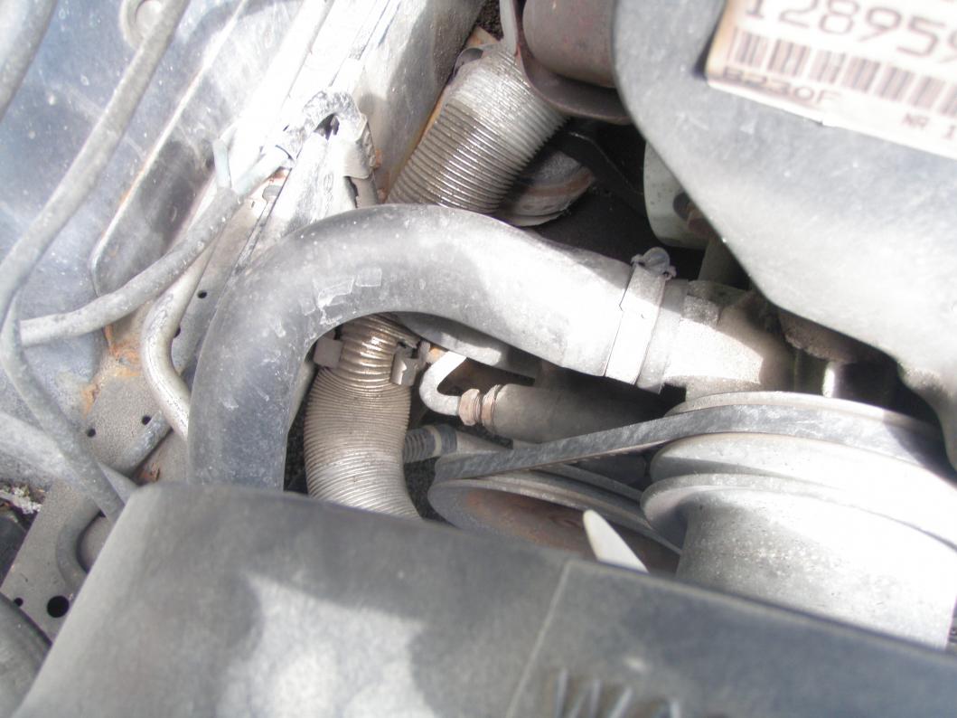

Also - check out the attached pic. The corrugated hose in the photo has a small hole in it. What is this hose? It runs from the air filter box, behind the radiator, and connects into the passenger side of the engine.

Thats the pre-heat hose, which allows in hot air when the temps are cold. The problem is the thermostat in the air filter box can stick open and the hot air will cook the air mass meter.
If you have a Bosch air mass meter (with the part number ending with 016) then I'm pretty sure you have the LH2.4 system.
Look for split vaccum lines and hoses.
